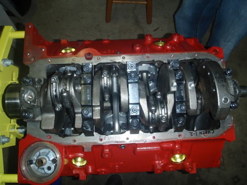

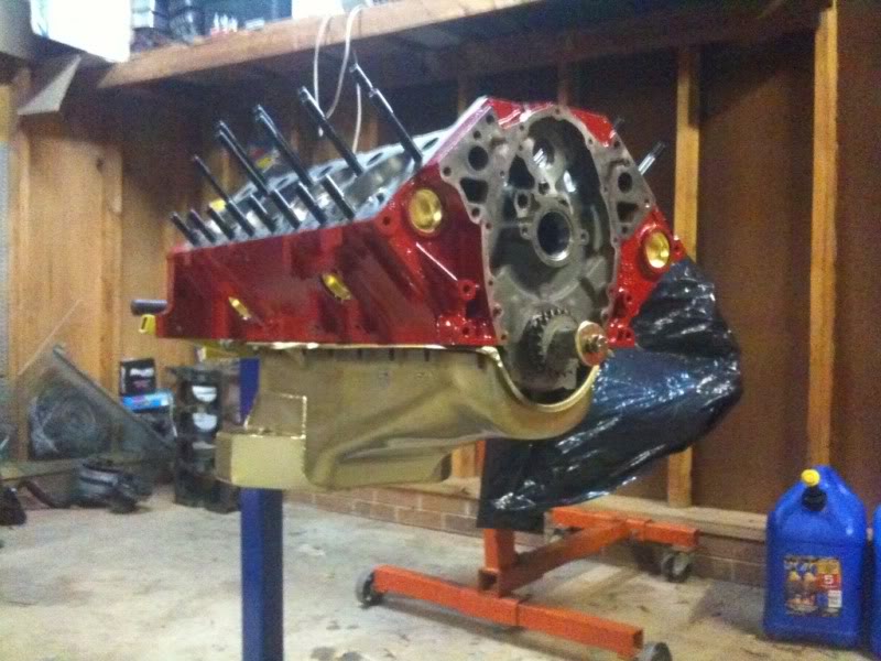

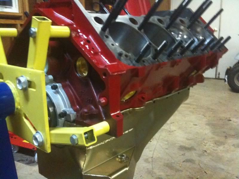

update-
Got a car for the motor lol
Short block is put together.
Still need to order custom cam
12.5:1 Compression
Bolting heads on tonight

Old Feb 25, 2011 | 12:46 PM
  #22
Mswezey's Avatar
Joined: Aug 2009
Posts: 312
From: Wichita Falls, Texas - College. DF-Dub, when not in college
Re: 383 Stroker LT1 Build
looking good!

Old Feb 26, 2011 | 11:12 PM
  #26
silverz28's Avatar
Joined: Jun 1999
Posts: 391
From: TX,USA
What happend to the cool stickers on the pan?
How about an update with a parts list of what you've got there? What are you looking at quench, head flow, head gasket, cam, and valvetrain wise?
-Dustin-
Old Feb 27, 2011 | 11:22 AM
  #28
spilner's Avatar
Joined: May 2010
Posts: 189
From: Lake Norman NC
I took them off to clean up the pan real good. I may put some back on. I can make em so its not a big deal.
-Dustin-
The gaskets I got ended up being for a 350 not a lt1 Gotta get some new ones but they will be a .040 thick gasket. Heads are 249/189. I still need to figure out what custom cam #'s to run. Once I get that figured out I can get alot of work done.
