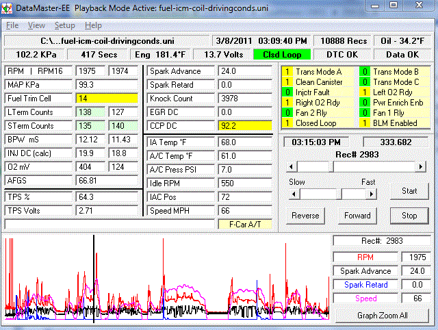

I posted a response on the other site you posted this on. Looking at your data logs, you have a lot of problems, including massive knock retard every time you push the throttle, driver's side O2 showing way lean in PE mode (WOT). Driver's side adding a bunch of fuel with the long term fuel corrections. Passenger side adding about 1/2 as much. After hard driving, even though the TPS sensor returns to 0.65V, the idle stays up around 1,000RPM, the MAP is too high (48kPA) and the IAC is commanding full open, even though its idling way above the programmer idle speed. That's the part I can't figure out.

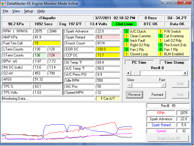

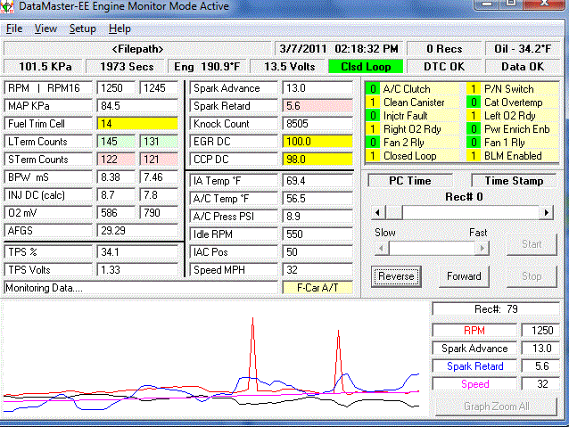

Update: replaced thermostat (stock 180-degree). I bled for air. Car still took 350-450 seconds to reach closed-loop temp. It is about 40 degrees outside, though.
Also checked the MAF and boot for damage or un-tight seals. Everything is good and tight and properly fitted.
Checked EVAP vacuum line that wraps around the throttle-body and found no cracks, holes or damage. I still have to get behind one of the wheel-wells to access the rest of the line between the EVAP solenoid and the canister.
Now that it has been pointed out in the data recordings, it's beginning to make some sense as far as there being so much activity with the CCP DC and EGR. Both of those are VERY active and always active anytime I'm pressing the gas. There is spark-retard, CCP DC and EGR activity coinciding with throttle. CCP is more frequent, I believe. I'm not sure what is supposed to be 'normal'. Here are a couple of screen-shots (last one is at idle):
Here is one more of today's idle after driving 10-15 mins into closed loop:

Were you goosing the throttle to get those RPM spikes, or are they data errors? You have the same problem in the hot data logs you sent me. At the end, the throttle is fully closed, but the RPM spikes from the 800/900RPM idle speed to 4,000 or 5,000 RPM for a single data frame, and there is no indication of "DATA ERROR". Could be erratic signal from the cam position sensor in the Opti, including possible interference from a high voltage wire running too close to the Opti harness, or spark jumping to the Opti case. Have you ever open the hood in the dark and looked for arcing around the distributor?

Originally Posted by Injuneer
"I don't think you have a problem with air bypassing the MAF sensor. The sensor readings indicate its picking up what its supposed to pick up. The question is why does it go out of control when heated up - high idle, high MAP, high IAC counts, high MAF reading, and the PCM is making no attempt to correct it.
The other thing that stands out in the data logs is the frequent spurious high RPM readings. It's idling at 800RPM, then for a single frame of data the RPM spikes to 4,000 or 5,000 RPM. That may be indicating erratic readings from the Opti cam position sensor. Look at the logs and there are the huge spikes in the red line indicating RPM - yet the throttle is still closed. That is sometimes seen in the logs when there is interference on the ALDL data line, but you will get a "DATA ERROR" indication when that happens. I'm wondering if you have a spark plug wire running very close to, and in parallel with the harness wires for the Opti. That would be enough to introduce electrical interference in Opti readings. Maybe you are getting some arcing from the high voltage wire to the Opti case?????"
Is it going to be important to dig into the rest of the vacuum line from the EVAP to the Canister? I was going to do that today or in the next day or two but if it's not necessary, the wheel well can stay on. Again, thanks for the feedback. Much appreciated.

A couple screenshots yesterday's driving/recording data (below). If anything strikes anybody, please feel free to chime in!
This is recording (rather than monitor and screenshots like also-recent images above) after adding 12 gallons of hi-octane fuel (I learned that's a MUST), replacing the thermostat, ICM, and Coil. I re-checked all the intake stuff and re-routed a couple wires in case they could have been causing interference (someone's suggestion also). I re-seated a number of connectors and made sure the intake/MAF stuff was tight as could be. I found no cracks in any lines under the hood. I did find, and I'm not sure why, that the car ran better yesterday with less knock counts and less spark retard than the day previous. Perhaps the fuel is that important. Maybe it wasn't quite a hot as before, though this did encompass 12-15 minutes of driving. I did get a couple of solid 'misses' that I noted driving. It's definitely still not 'right'. Here are the screenshots from yesterday's driving (the second one is same as first but graph is zoomed):
