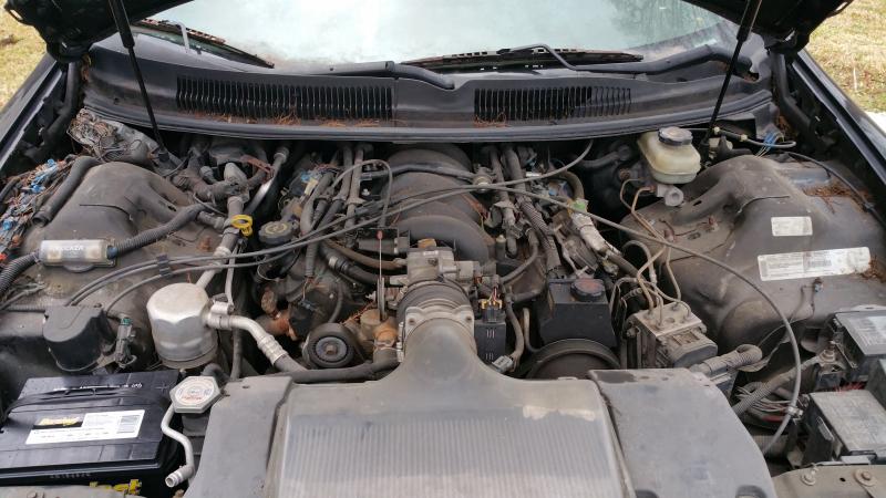

Ok, so it has been sitting up for almost 2 years. I stopped driving it because it had a misfire from around 1500-3000 RPMs. I decided to mess with it today. I put a fresh battery in it and cranked right up! Surprised me on that one!!!
I have asked multiple people on any thoughts on what could be causing the misfire. I've heard anywhere from a coil(s), injectors, etc. I think it is a coil because it revs fine without load, but once driving the misfire starts.
What I am getting at... How much do shops generally charge to diagnosis and replace (if it is indeed a coil)? I don't have a code reader, but it always has the code light on anyway when I was driving it. It has a cam/valves etc and it just always was lit up after the swap. BTW its a v8 swap/ECU from a 2000 z to a 98 v6.
Also, what is the best way to clean an engine bay? Pics below. I have always been afraid of spraying the engine with water, etc. Good ole scrub down?
