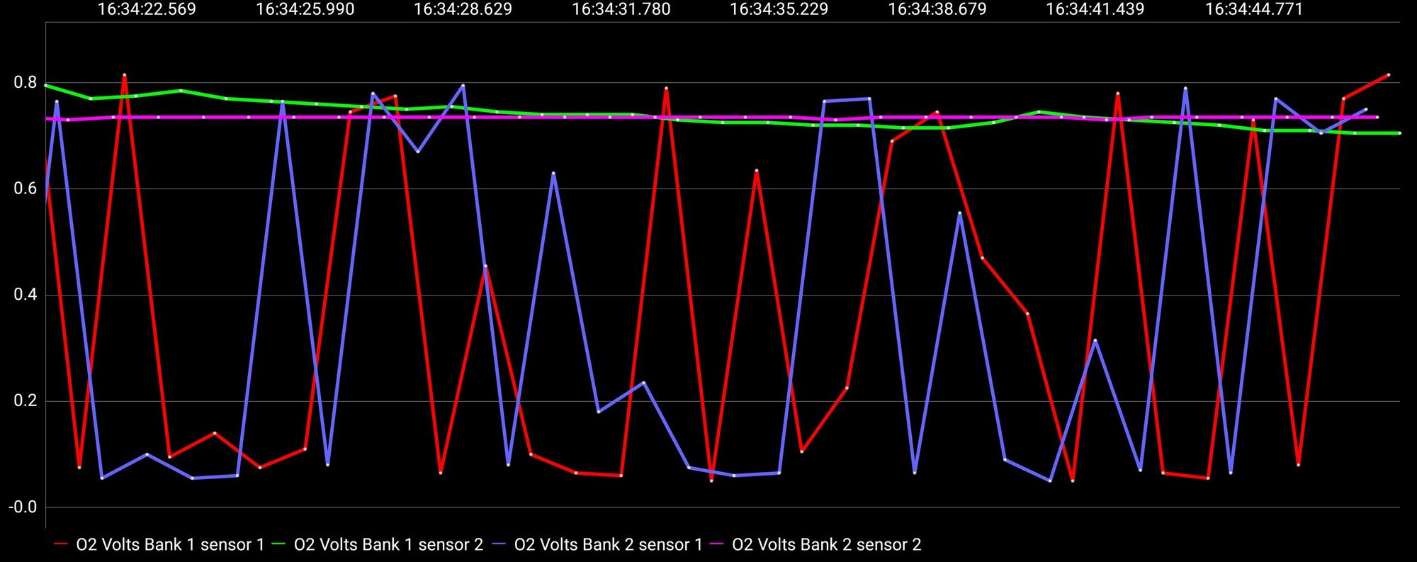

A couple of days ago my '00 Camaro SS with 84000 miles on it threw a P0420 code (Cat effectiveness Bank 1). The Torque app shows that the O2 sensor readings for the downstream O2 sensor of bank 1 are normal for a little while, then suddenly crash and after a while recover, sometimes fully, sometimes they crash again. The right bank downstream sensors remains relatively flat. I cleared the trouble code, but it came back within minutes.
The other thing I saw were high misfire rates in torque. Not sure whether the two observations are related or not.
I replaced the O2 sensor (cheap, was hoping this might fix it) and reset the code, which stayed away almost all of today. Got the car smogged and 'passed' but as I hadn't driven the required 200 miles after code reset (I didn't know about that) have to go back. And the Camaro threw a P0420 again in the late afternoon. I replaced the spark plugs on the driver side because I saw high misfire readings in torque and found the gaps in the old ones were huge, but the behavior of the o2 sensor did not change.
Now the question is, is this the cat (I thought that if the cat is damaged I should feel sluggishness at WOT and also if the cat was damaged wouldn't the readings be universally low instead of going up and down? But what could it be? Wiring? Spark plug wires? Something entirely different?
A Walker Cat is $320, so that wouldn't be breaking the bank, but I would like to avoid spending them if it turns out not to be the cat.
The car seems to drive fine, though I think my mileage is pretty bad at the moment. I saw a slight improvement in engine smoothness after I replaced the O2 sensor, but that could be my imagination.
The sensor I used is a Denso 234-4025 which supposedly fits my car. It physically fits and plugs in properly. Spark plugs are NGK TR55 Iridium.
I'd appreciate any advice and opinions.
O2 sensor readings:
Left: Bank 1 upstream vs downstream, right: Bank 1 vs Bank 2 downstream.

That graph tells me you have 1 good working O2 and 1 that is shot.
At 84k the all the O2’s, plugs, wires and possibly the cat is shot. Generally the 0420 code is a bad cat. The Magnaflow cats are decent as well.

I swapped the left and right O2 sensor. The graph still looks roughly the same (right-good, left = bad. I replaced the 4 spark plugs on the left, the 4 on the right are going to be replaced next weekend. I know #8 is the difficult one. Spark plug wires are on order. I think the spark plugs took care of the misfire (didnt feel that, but saw the counters). After the reset the misfire seems to be gone. Let's see whether that stays. I have not had a new P0420 yet, gonna drive the car to work tomorrow to see whether the code will return. If the wires dont make a difference Im going to order a Cat. Magnaflow is a lot more money than Walker (320 vs almost 500, is the Magnaflow cat that much better?

Which bank are the misfires on? Was the SES light flashing? Did you feel the engine misfiring?
A misfire dumps raw fuel and air into the exhaust. The O2 sensor sees the air as high O2, the PCM assumes that bank is running lean, and adds extra fuel with the fuel trims. That fuel/air burns on the cat, overheats it and damages the cat. The heat can crack the substrate and blow the innards out the exhaust pipe. Get it hot enough, and the substrate can melt and limit flow. It is the last extreme that you would feel as a loss of performance, so apparently you didn’t reach that stage.
Suggestion - use only OEM/AC Delco O2 sensors. GM cautions in the factory service manual that aftermarket O2 sensors can cause problems with the cat efficiency diagnostics.

Here is the newest, from today: All emissions tests readiness values show green, except for Secondary air system, which shows incomplete. This includes misfire (also green). Also the graphs for misfire in the Torque Pro app show a solid zero for misfires for all 8 cylinders. In the 'vehicle test results' section I still get the TID: $0c CID: $30 misfire count (calculated) Not OK. II replaced all spark plugs on the driver side and will replace all spark plugs and the spark plug wires on the passenger side on Saturday.
The car still drives as normal, no codes, no SES light.
I also did not get any of the misfire trouble codes (P03xx).
Ill also clean the EGR just to be on the safe side.
If the cat turns out to be bad its going to be ~$300+tax, I can live with that, I would just be mad at myself for spending $300 to replace a cat and still be saddled with the same problem, so I am trying to address everything I can before thinking of the cat. Its been several days since it threw the last code, so I can only wait and see.
