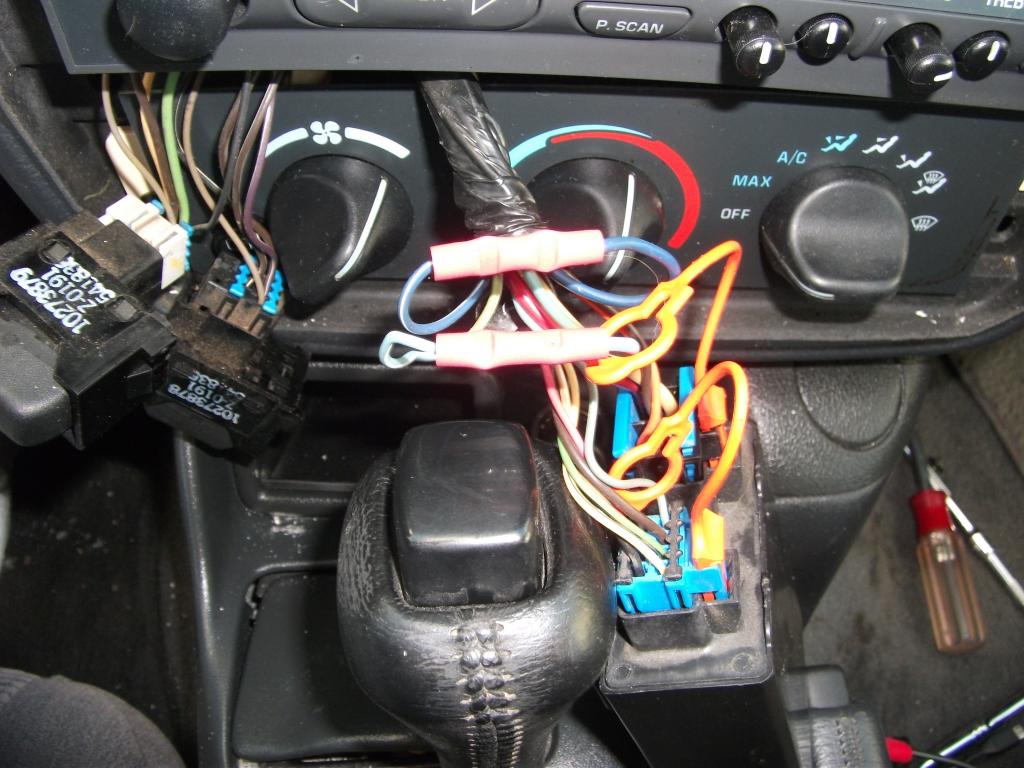

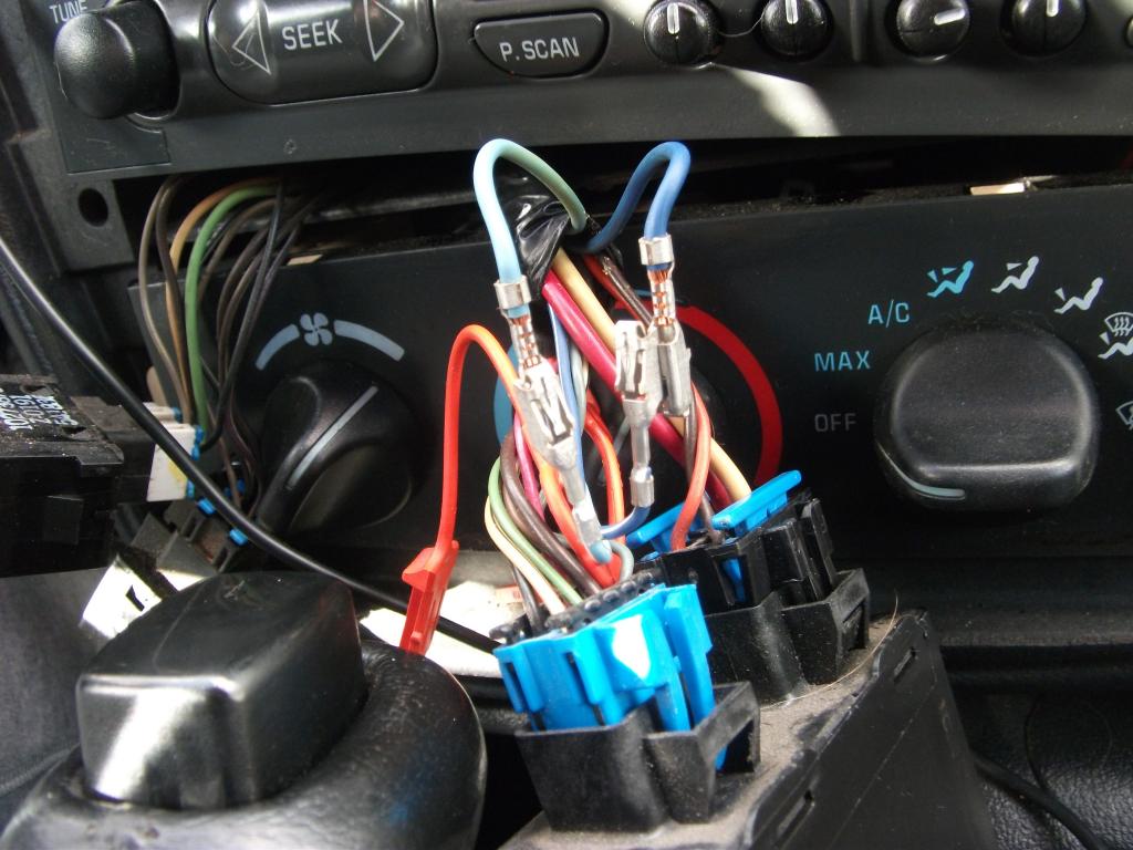

here is what he is talking about, I did this sometime back and it resolved all my L/F turn signal issues
