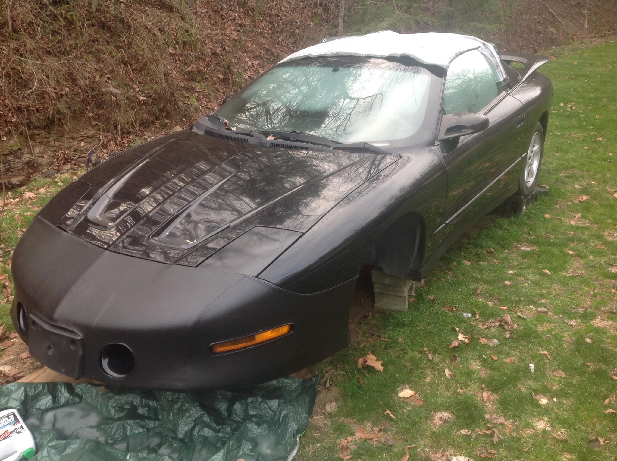

Here's the dilemma, as most of you know i spent this past winter rebuilding a nice motor for my 95 TA. All that has been keeping it from being installed is that my garage is the front yard and the weather is crappy. Anyways, a buddy of mine just called and wanted to know if i wanted a complete T56 drop and swap for my 95 TA...My question to all of you guys and gals is:.....Is it worth the trouble it will be to swap from my A4 to a T56? All input, suggestions and comments are greatly appreciated....Thanks!
