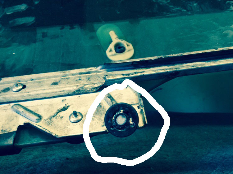

Not sure if I should have started a new thread or not as this is really the same problem as posted above.
Apparently the reason the motor/gear has gone bad(a second time in fact) is the roller on the window sash, which I believe is this part here, is bad. Its attachment point to the metal sash is very loose and the swivel-like attachment at the roller end is bad as well, the assembly is well worn and loose and has been putting excess stress on the motor/ratchet assembly.
Below are some images of the part I'm referring to.
My problem, and the problem my shop is having is located the part itself.
So my questions are, does anyone know where I might find the part, and if it's not available, is possibly the roller assembly itself available and/or is there another solution? Possibly detaching the existing bad roller and re-attaching a new one, or something that would work as a new one?
The sash itself appears to be riveted to the window itself so I'm not even sure that part(if even found) can be attached to the new window.
My body shop is still looking for the part but I said I would check with the brain trust here to try and get some insight on a path to take on getting the window working again.
Thanks much!
Jim
