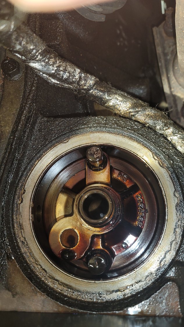

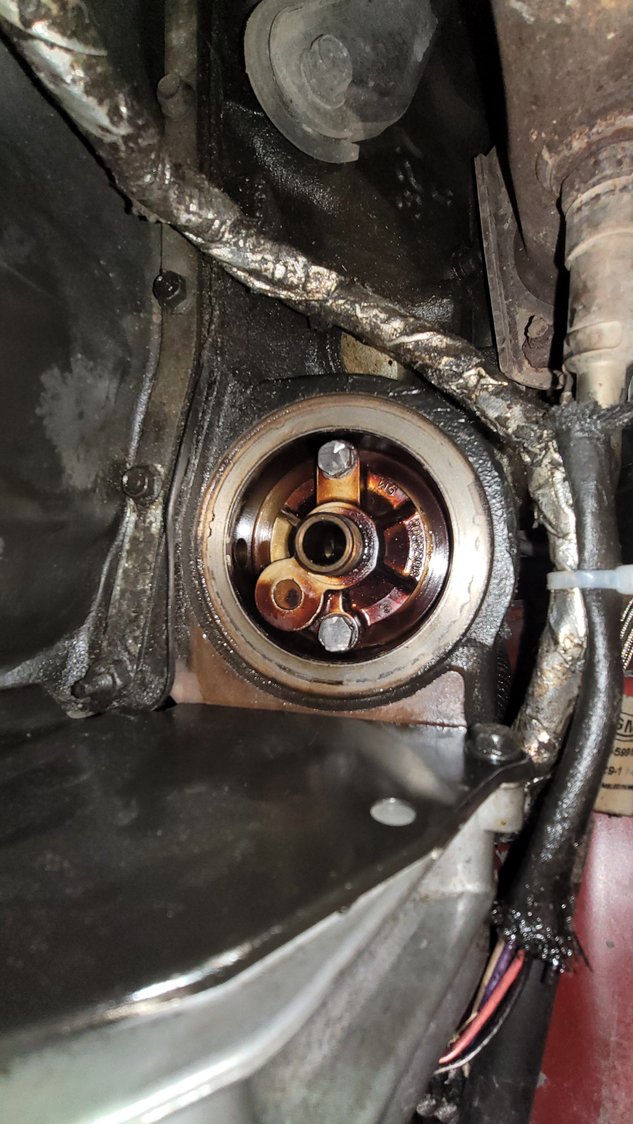

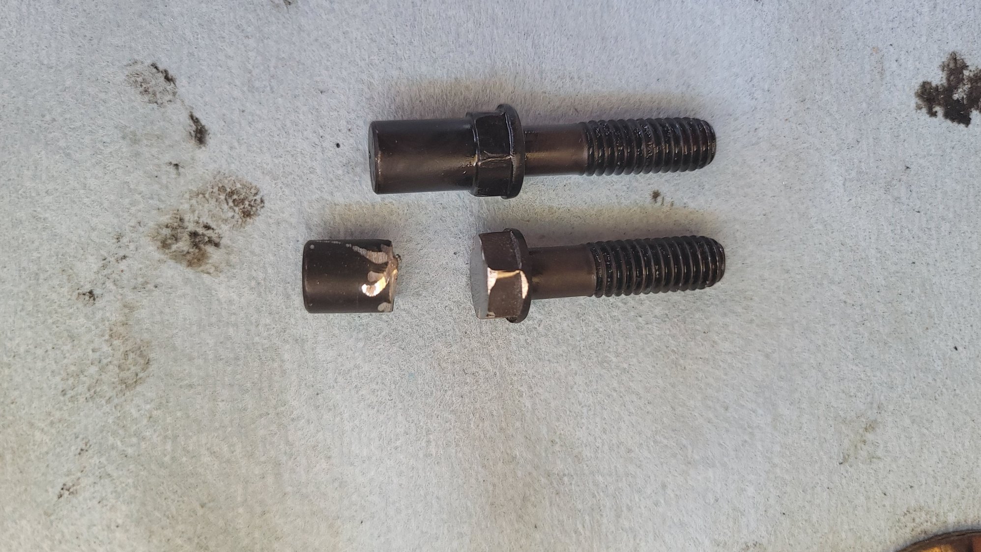

So I ended up using the existing bolts, and dremeled the studs off the heads with a small cutting wheel, then reinstalled the adapter. It makes more sense once you get the oil cooler lines/hoses removed from the vehicle.
Oil cooler removed with lines and hoses attached. Also started to cut the heads off the studs on the bolts that mount the adapter plate shown on the left above the bolts.
View of adapter plate still bolted to the block with studded bolts. Cutting the studs off the heads of those two bolts allow them to be reused to mount the adapter plate and not interfere with your oil filter installation.
Adapter plate reinstalled with modified existing hardware bolts.
The stud portion of the bolt removed.

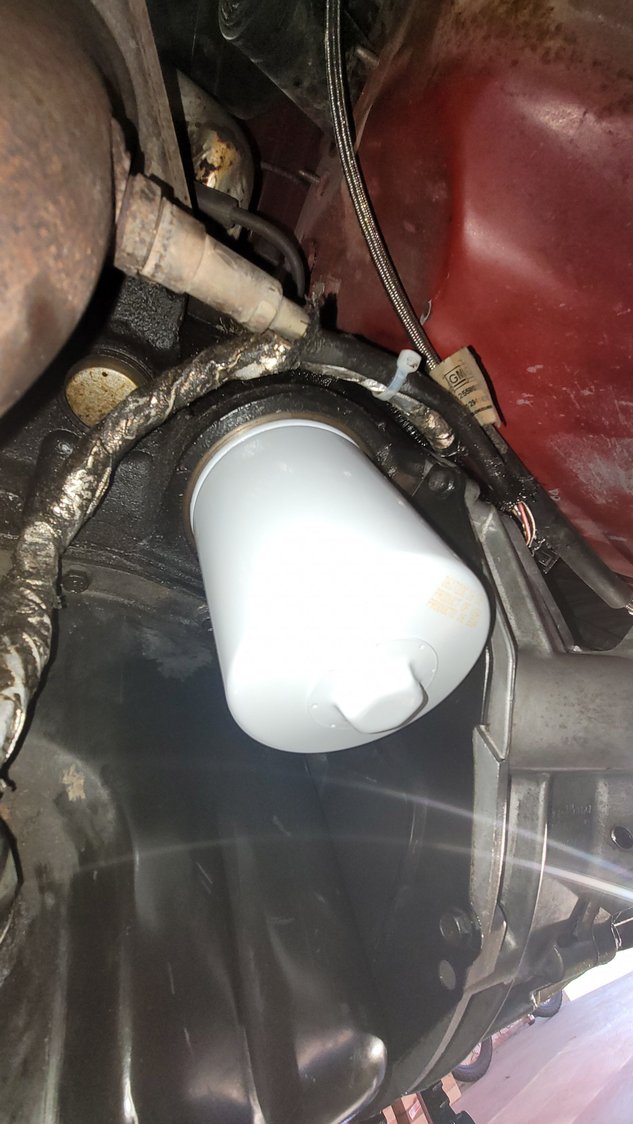

K&N Oil filter installed hand tight after putting some oil on the seal and pouring some in the filter.

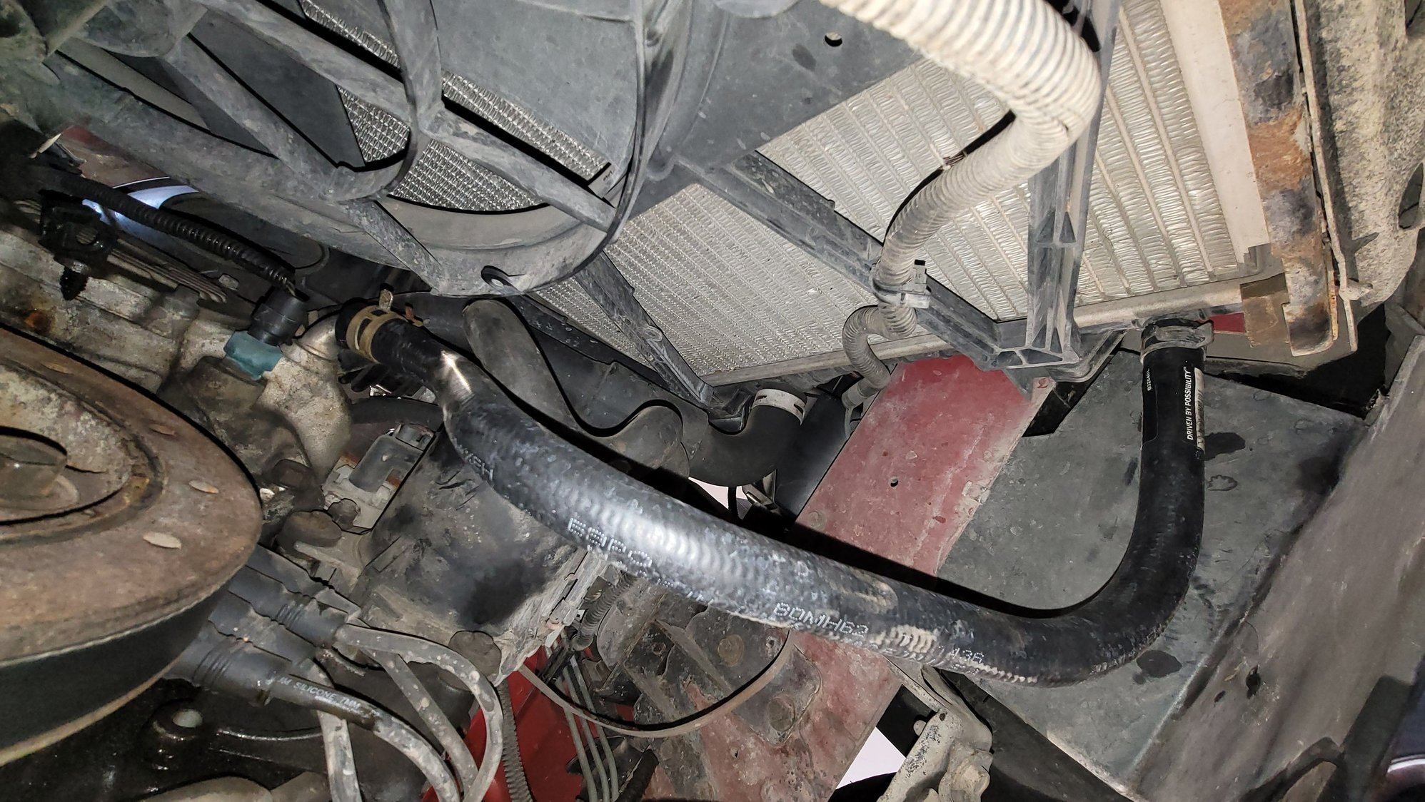

Bypass hose installed from radiator to water pump.
