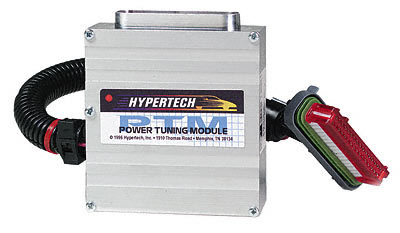

Can someone explain, or take a picture of where a hypertech chip might be placed? I'm having code 51, and wouldn't you know it, several years ago (and after thousands of dollars spent on repairs) my dad admitted to me that he put a hyper chip in the car, but that he took it out.
How the hell can I make sure the damn thing isn't still in there? Where is it located? I'm a complete newbie when it comes to the electrical stuff, so I need somebody to explain without throwing a bunch of acronyms and abbreviations at me. Can someone please provide me a picture of where it would be located and an explanation of what to do to get to it?
Old Jun 17, 2010 | 10:29 PM
Posts: 71,098
Are you asking about the 95 Z28? If so, there is no replaceable chip. 93 is the only year with a replaceable chip (It is possible to have a later model PCM "socketed" for a replaceable chip, but that is very seldom done). There is a Hypertech "module" that connects between the PCM and the harness connectors. If you pull the PCM/holder off the fender, you should be able to tell if something has been added.
