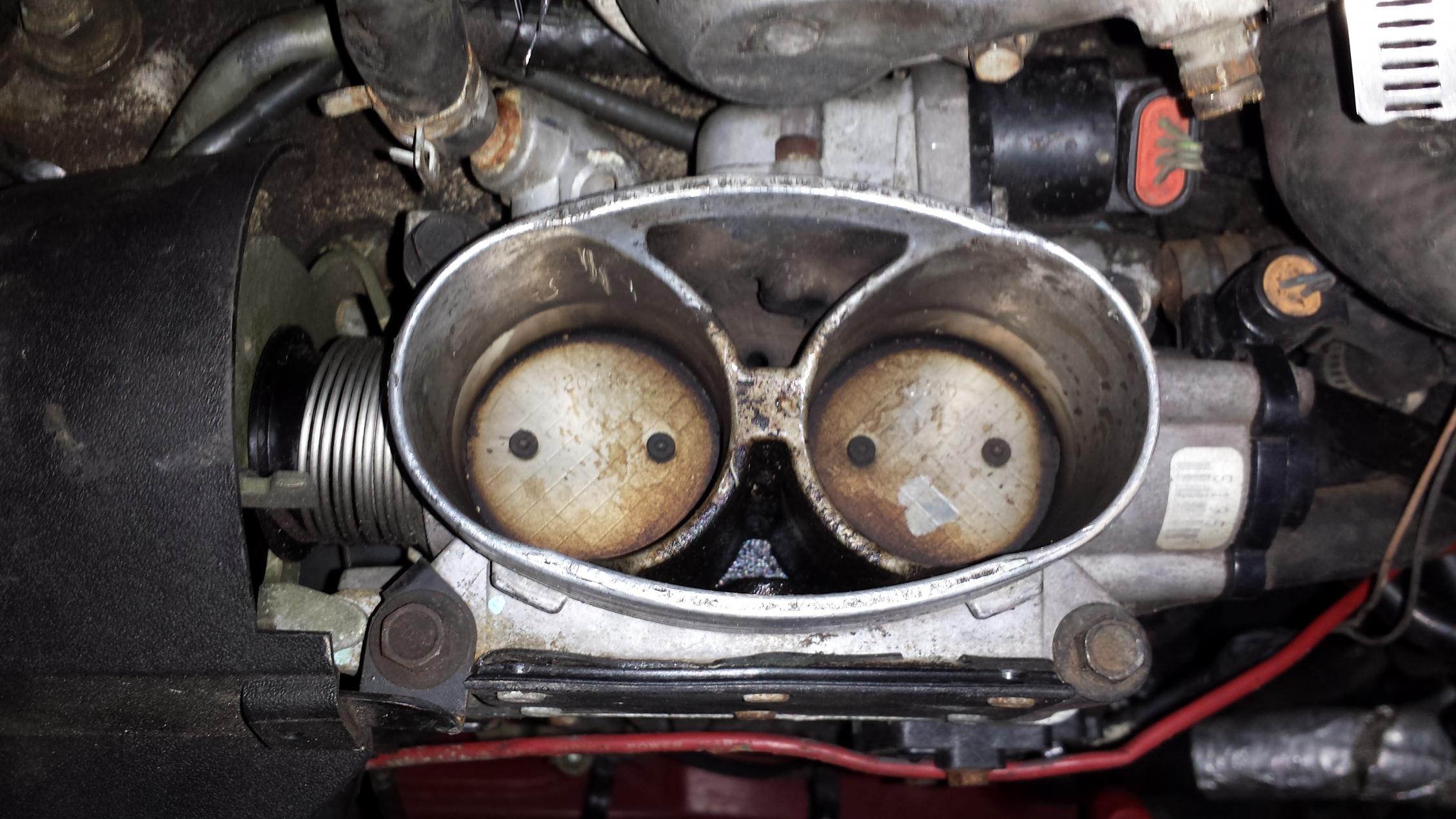

Alright guys! I got the new water pump and New temp Sensors installed and the fans ARE working! Woop woop! I was VERY careful NOT to let any water got on my Optispark too! BUT now the car is running a little rough and the Check engine light is on. I know what you're going to say, "check the codes". I will later Wednesday but I think it's because of a vacuum line. I'm not really sure what it is. I've posted a few pics to let you see what I'm working with. The first is of my throttle body. Is there anything I can clean it with? Looks like some soot has built up on it a little.
Cooling fans (I'm not going to let this beat me!)-20141125_233502%5B2%5D.jpg

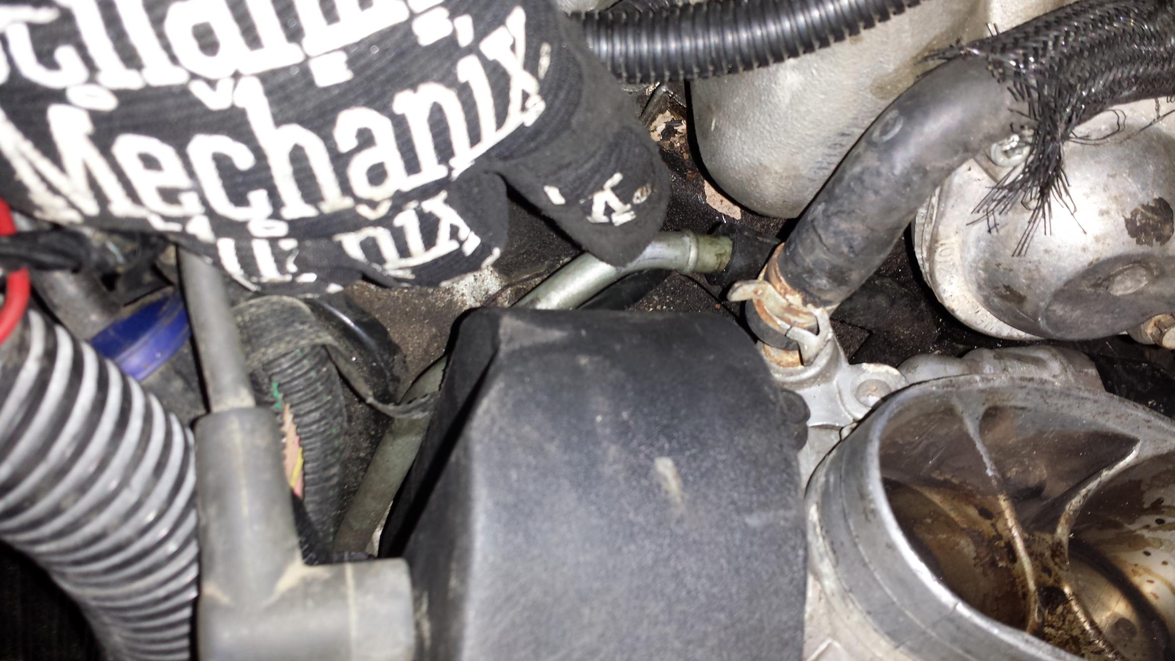

Here's what I think is a vacuum line. This line is barely hanging on and doesn't look like it's secured very well. Maybe I need to put a zip tie or something on it.
Cooling fans (I'm not going to let this beat me!)-20141125_233619%5B1%5D.jpg

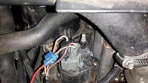

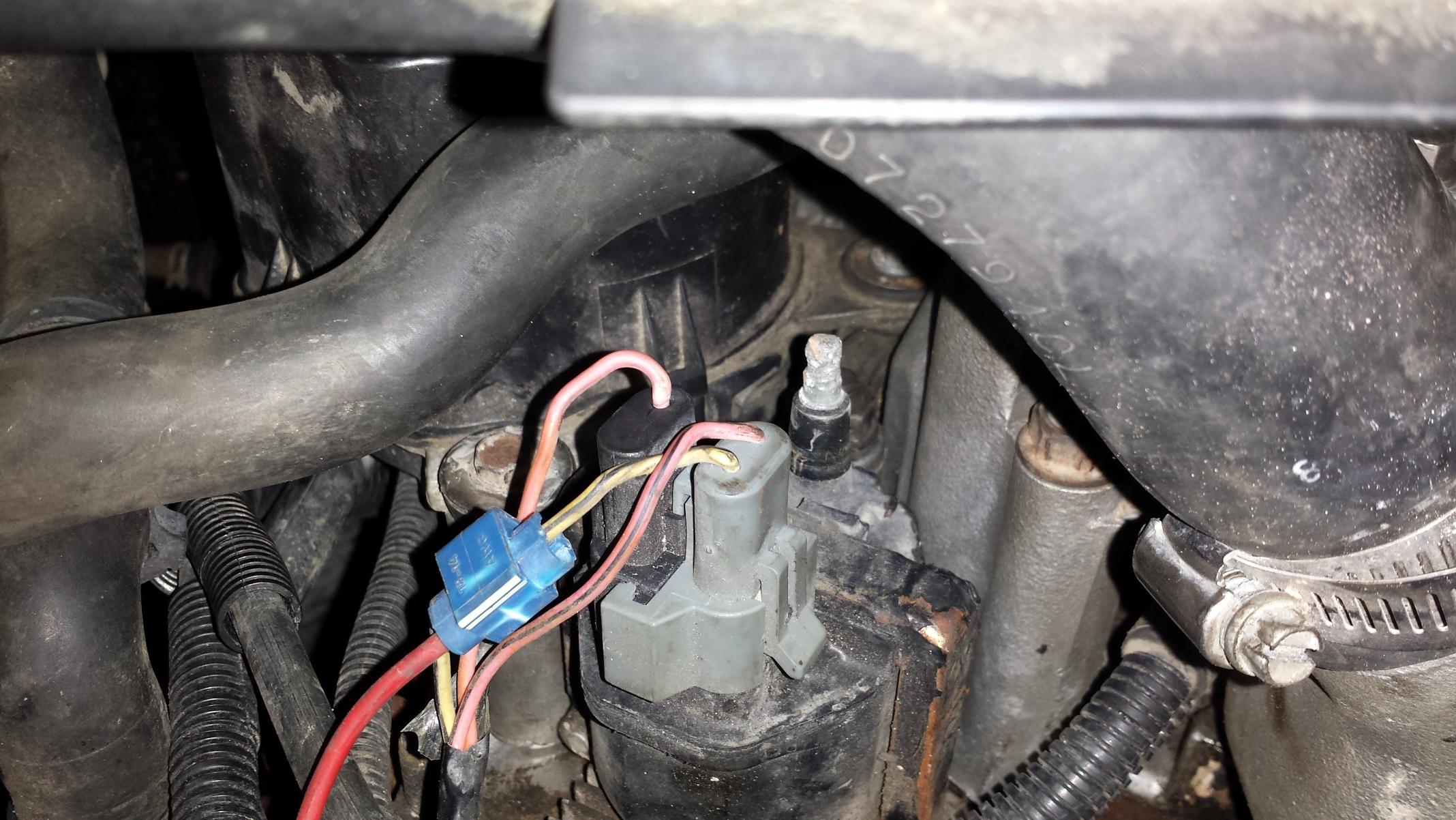

And for the love of everything sacred, can someone please tell me what this thing is? I think it's something to do with the ignition, maybe the "Coil". Why is it so corroded?
Cooling fans (I'm not going to let this beat me!)-20141125_233549%5B1%5D.jpg

PHOTO 1:
The throttle body can be cleaned with "throttle body cleaner". Oil buildup is fairly common. Take the top cover off the throttle body and check for oil buildup. When you take the cover off, the gasket is going to be all shriveled up, and should be replaced:
Throttle Body and Air Intake Cleaner, 05078, CRC Industries
http://shbox.com/1/t_body_kit.jpg
PHOTO 2:
The metal to rubber connection is the vacuum source for the PCV valve. It doesn't need a clamp, but it should be connected better:
http://shbox.com/1/pcv_pipe.jpg

Bottom picture, with rust and peeling black paint is the ignition coil.
You need to use Shoebox's site as a reference.... he has photos and diagrams of virtually everything you will ever need for a 1995 Z28:
4th Gen LT1 F-Body Tech Aids
http://shbox.com/1/coil_loc.jpg
Appears you pulled the wire off the coil, and have it leaning against the side of the throttle body linkage cover.
The fuel line bundle is supposed to be held up off the hot exhaust components by a plastic clip that goes in the side of the throttle linkage cover, about where you have the coil wire resting. You need to tie the fuel bundle up to avoid the possibility of it resting on a hot component of the AIR system piping, and melting a fuel line.

Could that corroded coil nipple cause a constant misfire? Didn't get a chance to have codes ran on my car today. Ordered the cables to do it myself though using GaryDoug's program.
