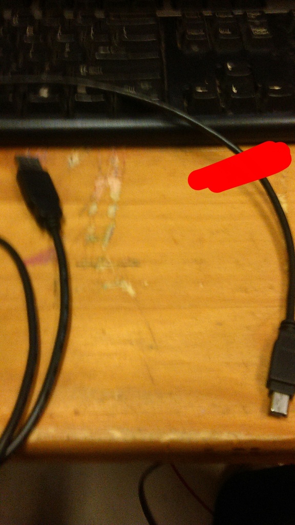

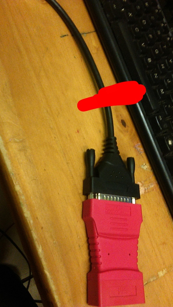

well the innova unit came with a usb and some cables that hooked up to the obd2 connector can i cut the cable and usb and use gary scanner? ima upload pictures in a second

Cut where these red marks are and make an connector?Name:  IMG_20150421_17452_edit_1429652732313_zps00qb8fpl.jpg

i get tht this scanner wont work. can i cut these cables and make the same cable?? so can connect to this scan9495

You cannot hack that cable to work.
Return the scanner. You were pre-warned about the Innova.
Go to the computer forum.
Get information about the cable you need and purchase or make one.
Get scan9495 sofware.
Scan your car.
