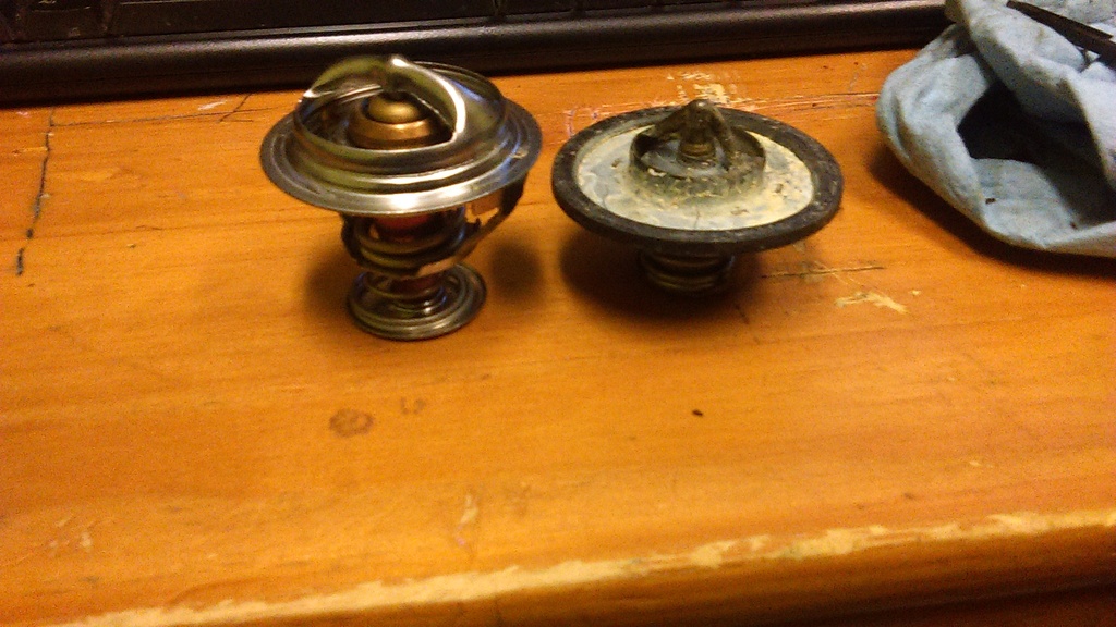

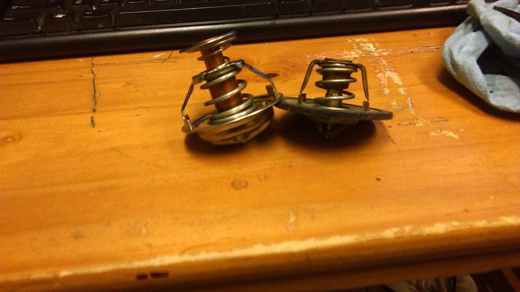

Re: coolant temp
i might of installed the wrong thermostat what do u guys think?? left is new right is old.
