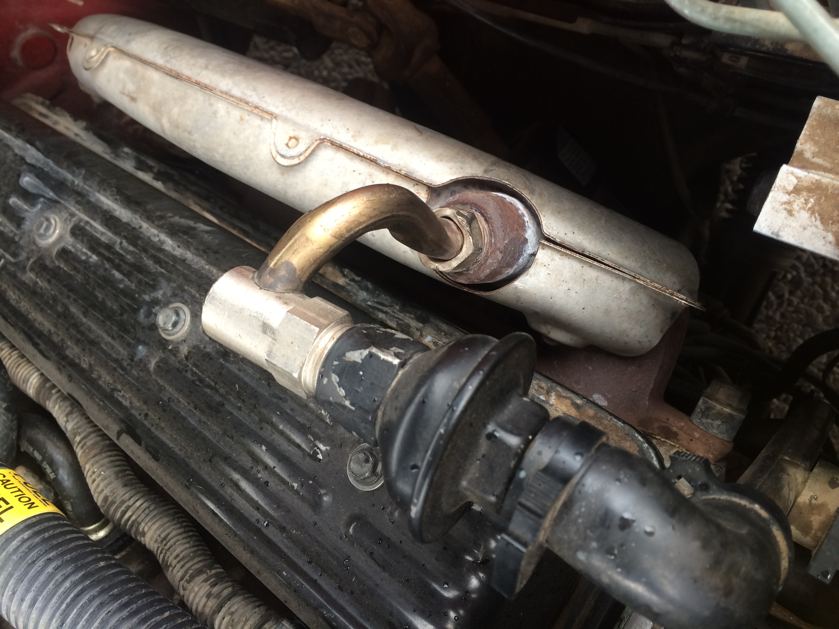

Haven't had more than a few minutes to look at the data log. The driver's side O2 sensor readings are certainly suspect. Always seems to read lower than the passenger side. It does cylce as required, but then, while driving, it just nosedives and stays at a very lean reading for a long time. I just need to look for what is causing that.
The AIR pump only runs for a couple minutes at startup. The data log has a "flag" that indicates it is commanding the pump on when it is supposed to be on. But that doesn't mean it is running. The PCM only monitors the relay control circuit, and as long as the fuse in the circuit and the relay are good, no code is set. The pump can be disconnected and/or removed in OBD-1 and it won't set a code.
I'm looking for signs that the pump is working. As the O2 sensors hear up, they should read extremely lean if the pump is working. Doesn't seem to be happening. Are the check valves for the exhaust manifolds in place?

Yes they are in place my drivers side one is bent tho could this be the problem or no? My dad did this to get the valve cover off a long time ago he said it was ok? I didn't believe him but anyways here a picture.
If this is the problem the air pump or the air value because i do not have a cat is the air pump necessary anymore would removing the whole thing fix the problem? Unless the pump still helps the car let me know what you think.
