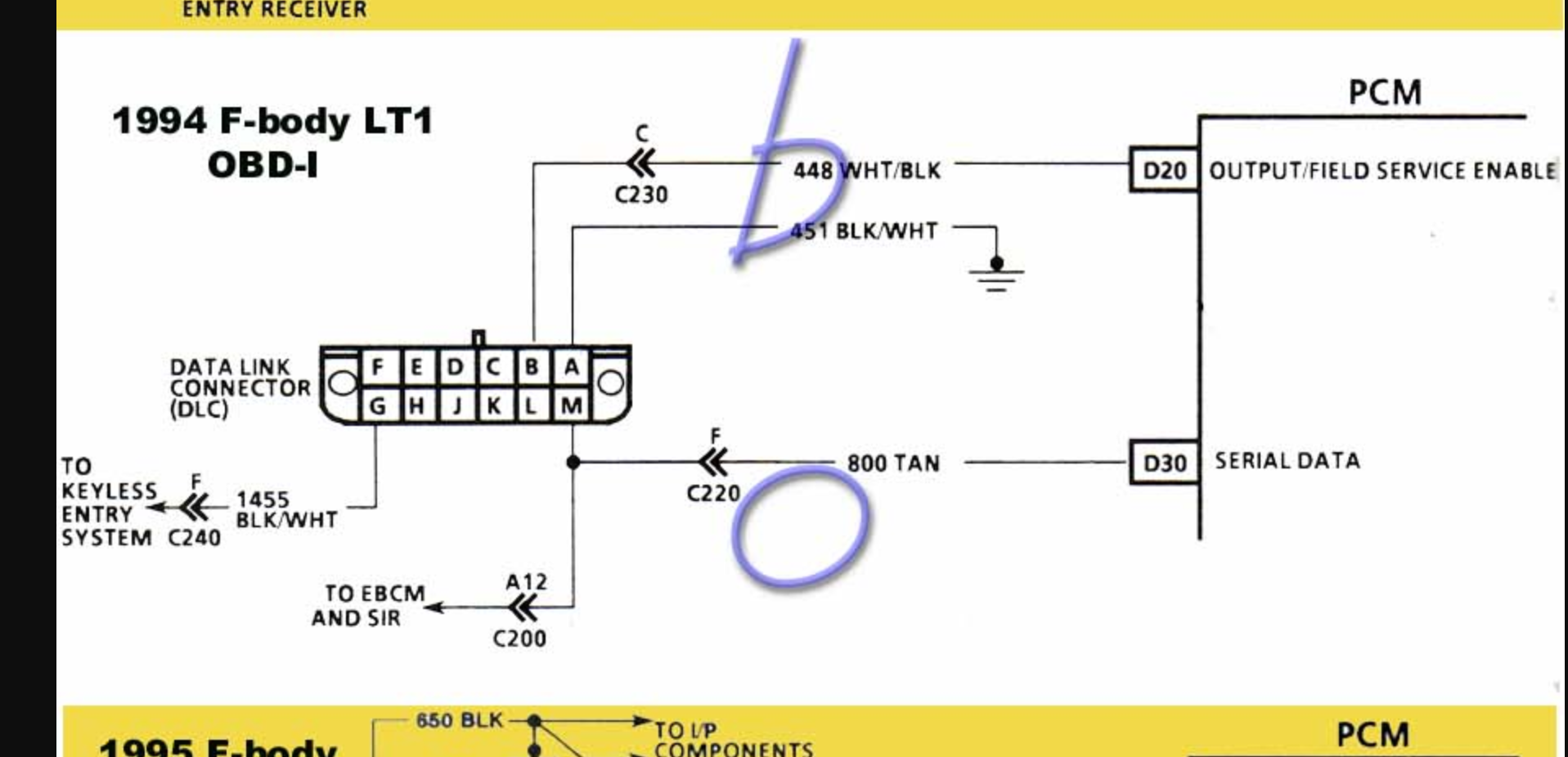

I haven't tried bypassing the keyless module yet. Before I do that a question, I did cut the lines to the old DLC as I use the OBD2 now. wondering if G in the picture below on the old DLC needs something. I don't have the full schematic so I can't see where this one goes to all the way. picture credit http://shbox.com/1/DLC_wiring.jpg

You can probably find the rest of the Pin G to keyless entry system circuit in the 1994 factory service manual. Free download, courtesy of GaryDoug:
https://www.mediafire.com/?40mfgeoe4ctti

Thanks for that bud! forgot about that, I have the manuals for my 96 that are hard copy and I know a lot changed. This is a good resource!
What I can confirm is that DLC now is really just for programming the keyless for transmitters. It gets grounded through a jumper to program a new remote, so it's ok that I cut that one. Also, looking at the manual, the fact that I have good grounds on the wiring tell me not a ground issue. All roads point to either this alarm internally that was on the car or the RAP which sucks more, I don't think those are service items anymore.
