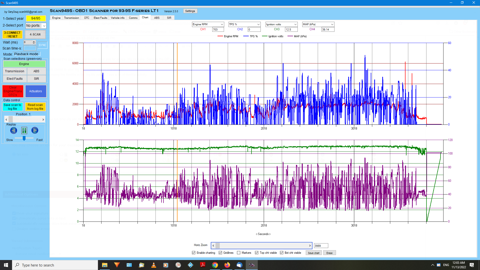

I have downloaded the SCAN 9495 software and built my own OBD-1 to USB cable which is working great btw (THANKS GUYS!!). I am now able to get to my DTC codes through the data logs.
But I am getting so many codes most of which seem to be very random so I have a hard time figuring out the problem. And I rarely get the same code twice! Could some of you guys help me decipher these datalogs?
My wild inexperienced guess from the codes that I am getting is that I have some electrical or ECM related issues.
I will attach below an example of a datalog from a recent drive and the error codes that I got during that drive.
DTC CODES from this particular drive:
24, 24/87, 14, 80, 47, 87/94, 19, 62.

Codes seem bogus…. several of them don't exist for a 94. They could be due to interference on the data line from the PCM to the DLC connector. Usually if there is a code that shows up on a single line of the log and doesn’t increment the DTC count, the entire line of data or a significant part of the data line may be corrupted due to the interference.
Do the coolant temp readings in the log match the gauge (1/4 max)? If the log data shows normal, higher temperatures, the gauge sensor or wiring is faulty. Should be easy enough for you to check.
What brand is the Opti cap? About 5+ years ago I found an error with an MSD Opti causing erratic idle and surges, with excursions as high as 2,700 RPM. When I sent the data to MSD they apparently found a defect in a batch of caps was causing the problem. Never gave me any details. Didn’t even say “thank you” for giving them the data.

OP, I do not see any trouble codes in your log file. Where do you see those?
Were you continuously pumping the throttle in the log file period. I see a lot of throttle activity. Or maybe this was just a very long log?

That is a very long log file. So that's why it looks like there is a lot of throttle activity. I am brand new to this kind of stuff so I do apologize.
I do not get any DTC codes that get saved or that are visible by the scan software.. But I've noticed the DTC box in the software flash red while the engine is running but nothing gets saved.
If I open the logs up as a spreadsheet and scroll down there are codes flashing in the far right DTC column (where it usually just says ---).

I would ignore any codes that are brief. Those are not real, just an anomaly of the GM PCM.

I will take a very quick look at the engine log. I really don't know much about the auto transmission.

1/4 mark of the gauge is 185-degF. In the log the coolant temp reaches 198-degF. The stock thermostat is rated 180-degF. That's when it starts to open. It won't be fully open until the coolant reaches about 200-degF. I don't see anything unusual in the data log you posted. What is the history of the car? Did you buy it used? If so, the t'stat could have been changed to a 160-degF, and the fan on/off temperatures reprogrammed to operate at lower temperatures. That's a popular modification.
If we reach the point where I can look at a log in detail, it has to conform to the steps contained in my post linked above. That requires a cold start.
Before spending money on the correct LT1 style thermostat (not the same as the normal SBC 'stat), test the one you have now in hot water to see at what temperature it opens.

When I first got the car the temperatures were always around 1/2 or above on the temp gauge once the car reached operating temperature. Recently the temps started to just get stuck at 1/4 mark and very rarely going above (whether I'm sitting in traffic or moving or driving long distance).
Occasionally the temps will rise above to the usual levels and then go back down and get stuck at the 1/4 mark again.
Also when I start the car I immediately hear the fans come on. I don't remember this ever being the case?
I have a datalog from a drive where the temps did reach higher on the gauge and it logged it in the data too. Recording temps up to 230.
The log that I attached above it stays around 195. Peaks at 198 but that's it. (and that was a long drive with traffic and highway speeds).
