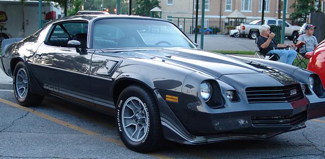

I think I want to paint it the original color, but Z28 scheme:
My cousin wanted a blue camaro back in HS, so he -no kidding- took it to maaco..
