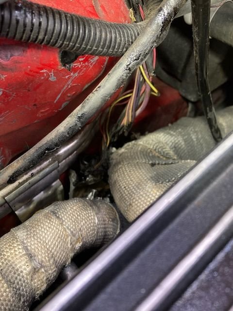

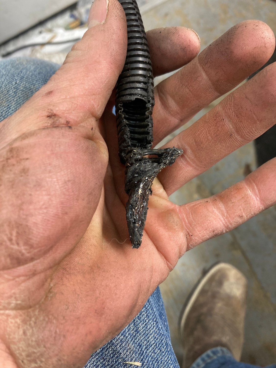

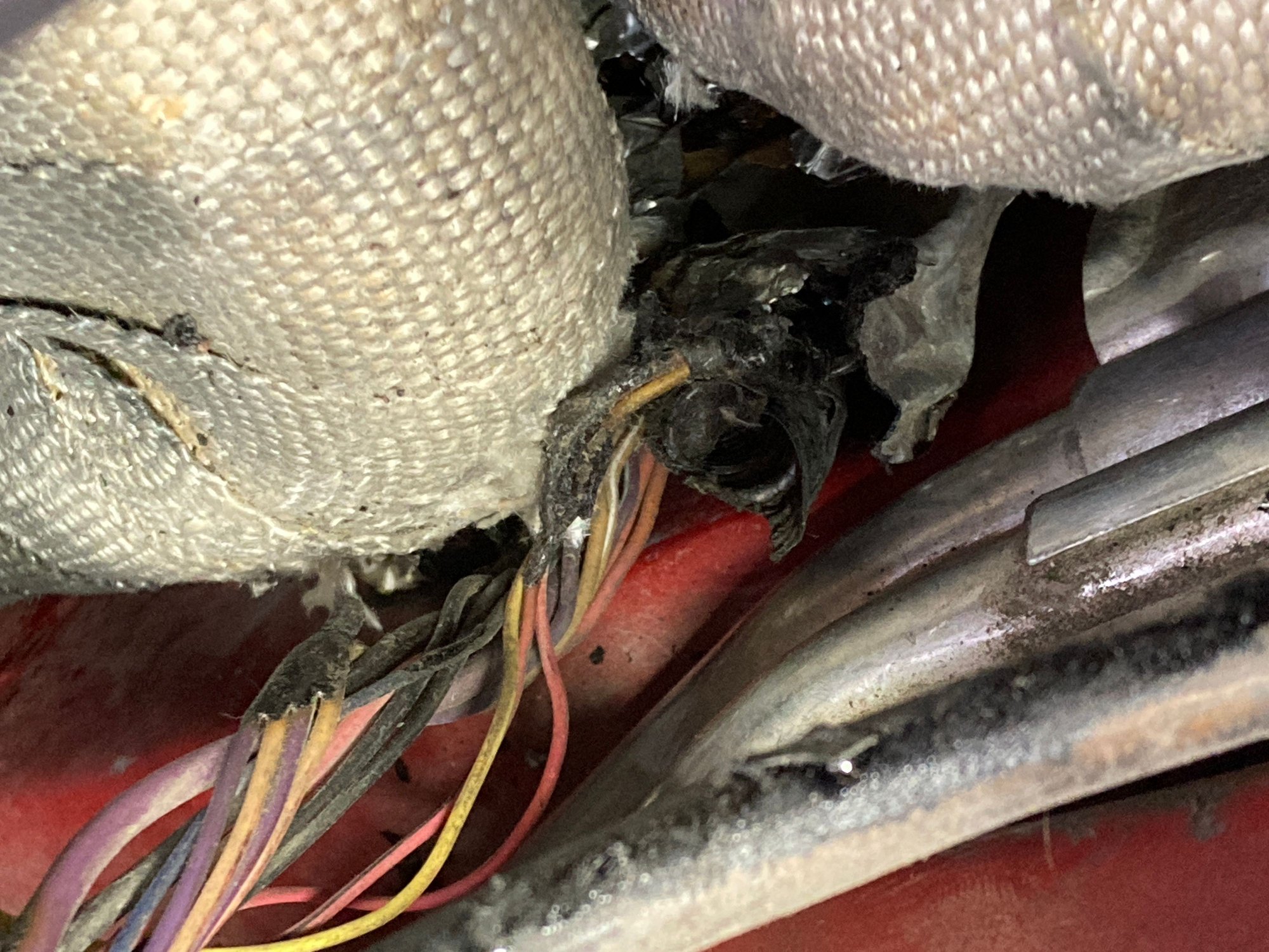

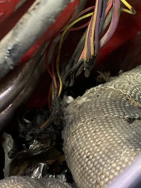

Fred I don’t know how you do it so easily everytime but all I can say is thanks for your expertise I just needed to quit looking at opti or fuel, your pcm comment made me poke the bear a couple times in the belly button and all I can say is thank you and keep my hopes up for a decent outcome when I get the entire passenger side engine harness rewired and rerouted a different way I can only cross my fingers the pcm isn’t hurt!!! Attaching a couple pics of my findings
Just a little bit of header heat on factory loom Ouch
Any ideas why I don’t have a popped fuse on anything

Hmmmm….. that’s nasty.
Glad to be able to help out, even if it’s only blind luck.

Well after hours and hours of dissecting loom and tracing wires and making sure my melted mess was fixed. I misdiagnosed a melted heat barrier as a bunch of melted insulation that was just melted loom not one bare wire or melted wire so back to square one comparing logs everything I see is exactly the same as prior logs on initial startup other than timing is at 13 or 14 degrees prior was 0 degrees and as soon as rpm registers timing advances. But I have Also found no spark, weak spark, and very iratic spark on different cylinders
