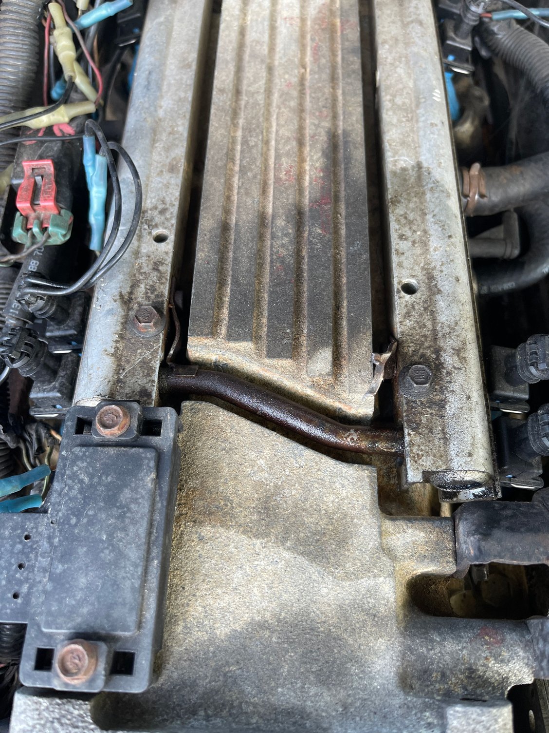

So I brought a z28 95 for 1000. The dude gave me a tranny with it. It also is sticking going from Second to third gear. But the major is the top of the engine when running it was spitting gas from up top. I’ve included a pic and video or try to put a video. Please help me guys I’m at a loss here
The gas will be coming from here. Is there a way to fix this or is something more trouble afoot?

Is the fuel coming out the ends of the diagonal cross-over pipe on front of the fuel rails (part 3 in diagram)? Don't see a video.
If it’s the cross-over pipe, there are small screwed on brackets (parts 4 and 5 in diagram) holding the pipe to the rails, and O-rings (part 2) on pipe. Looks like the bracket on the driver side of the rail is bent up.

ha it’s coming out that cross over bar. It seems people are saying it’s the o rings. Would it be prudent to replace the fuel regulator while I’m at it?

I ended up replacing that o ring, the fuel pressure regulator and fuel filter. Does not do that any longer.
