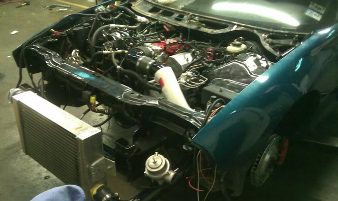

I am in the middle of getting my new motor in the car and started on my LTCC kit last night. I bought the LS1 coil relocation kit from Thunder Racing in hopes of easily hiding the coils like a couple of other guys here have done. After seeing a couple of pics of Ramair96WS6's car I was instantly sold. When I started to mount them yesterday, I immediately realized that the stock fuel lines, and the transmission dipstick were in the way. Rather than go to the expense of welding up a fuel rail and running AN lines, I moved the coils. I just wanted to show you guys pics, as I hadn't seen many any other alternatives online other than mounting them on the valve covers. I'll follow up with some pics up when it's all done as well.
Here is a shot of the whole engine bay so you can make out the close-ups

I mounted mine above the valve covers over the injectors

Its not an LTCC, but is it 8 LS1 coils on an LT1.... but we did this 10 years ago.
