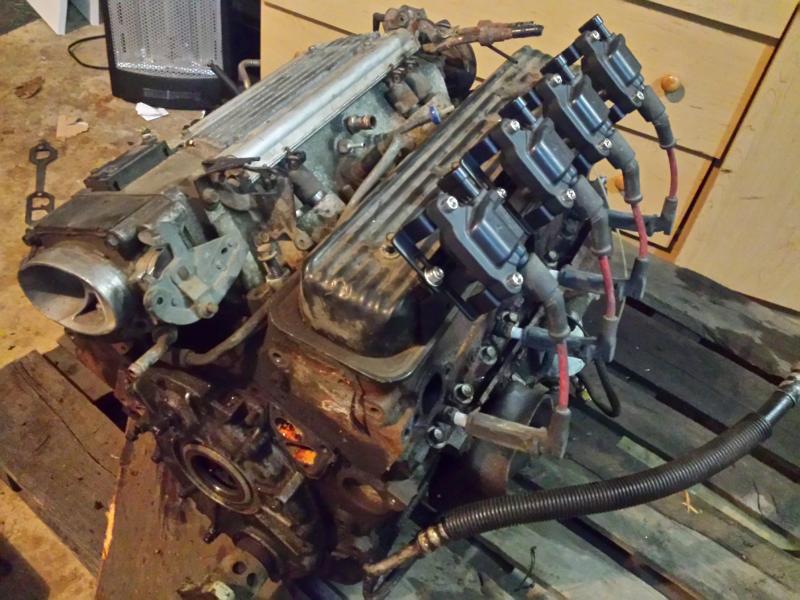

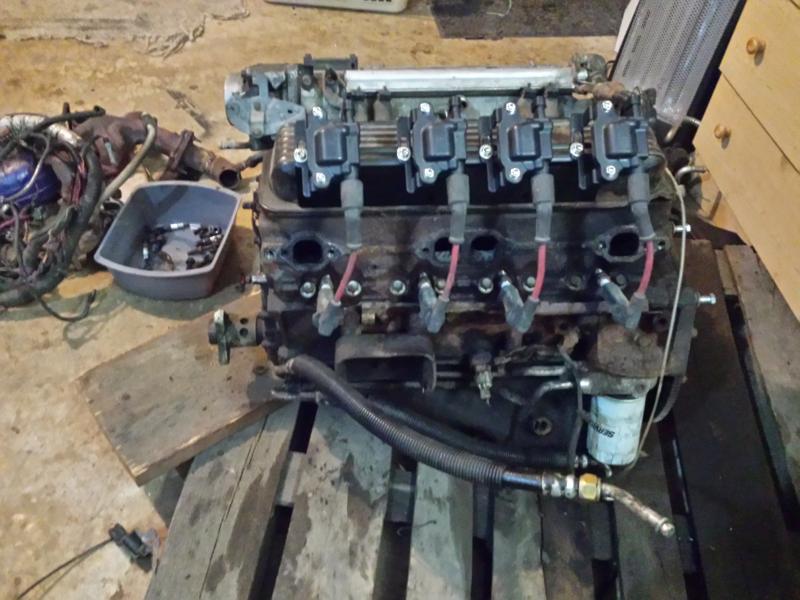

I picked up an extra LT1 over the weekend that will sit in the corner of my garage...probably forever, or until I need a rebuild. I have ordered my LTCC and decided to use my new engine for coil ideas.
This is the LS2 coils installed onto the Proform coil brackets. I originally wanted to use them like a fuel rail cover, but I discovered a new idea.

Starting the mock up

I like your idea but better double check you have enough clearance with the HVAC box.

will do!, I will see what they look like in the car!

Alternative approach, particularly useful when running a solid roller cam, requiring more frequent removal of valve covers.....
Out of sight, out of mind.

I bet I can get those brackets to bolt nicely under there too!

Don't use the "bottom" location on a supercharged setup.... broken belt tears the wires out.

I usually advise against mounting them to the valve covers or to fuel rail covers as I originally did. It looks nice but if you have to adjust the rocker arms it's a hassle.
