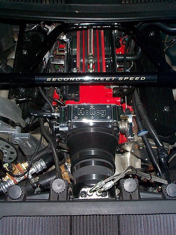

The Fernco 3”x3” sewer pipe connector (part #1056-33) is about $8 at big box stores, including two stainless worm clamps. Fits well, but goes on easier if heated in hot water for a few minutes.

That's a great solution, thanks for the picture too! Looks nice and stretchy if the coupler is only 3" ID on both ends.

The coupling is actually fairly thick. The clamps are contained in deep grooves. But it softens enough in hot water that it will stretch as you push it on to the throttle body. And once it cools it takes a set and forms a nice oval that fits tight, but is easy to remove and replace. When I bought that coupling 20 years ago, it cost less than $5.
The 3” in the coupler description refers to the inside diameter of the plain-end sewer pipe it is used to connect. The ID of the coupler is larger than 3”. But I never measured it.
Side view: (I have a 3” filler piece where the MAF sensor should be, because the engine runs speed-density, via a MoTeC M48Pro engine management system.)
