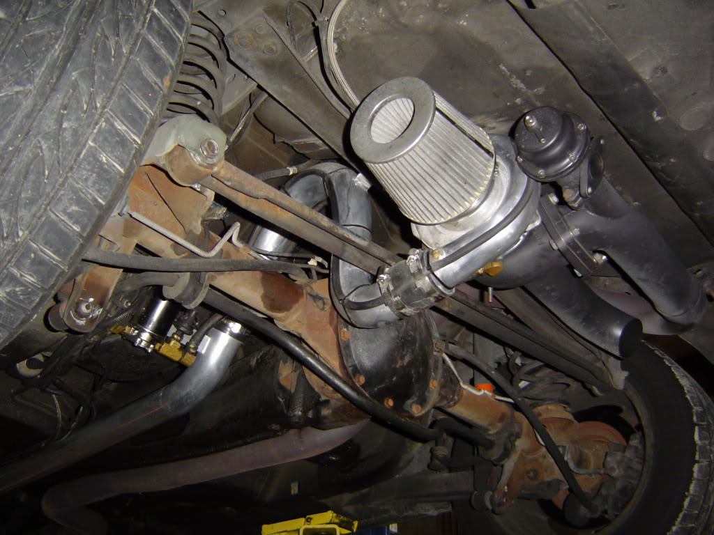

I put the turbo on last Sunday. It's a 76mm ball bearing P-trim with a .96 A/R housing. I've been making good progress on a new 2 bar tune, it's sooo much better that the old 1bar tune that it's not even funny. The transition into boost is really smooth and is even faster with the bigger compressor wheel; so much more fun to rail around town. Only running 7psi for now until I get the 2nd walbro pump in.
I'll try and get some pics of the installed turbo and piping tomorrow.

New pipes and turbo are on the car now. I put a hanger on the pipe that connects to the turbo's compressor. It sits on top of the panhard bar's crossbrace, so the turbo will never sag; it worked out really well.
I destroyed my 3.23 rear axle a couple weeks ago and swapped in a GU6 3.42 axle from a 6 speed. also got a set of polished cast aluminum valve covers from Ebay for $70, no more leaks there and they look awesome.
