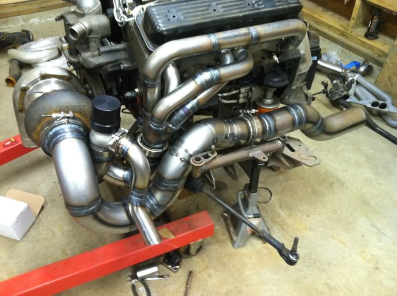

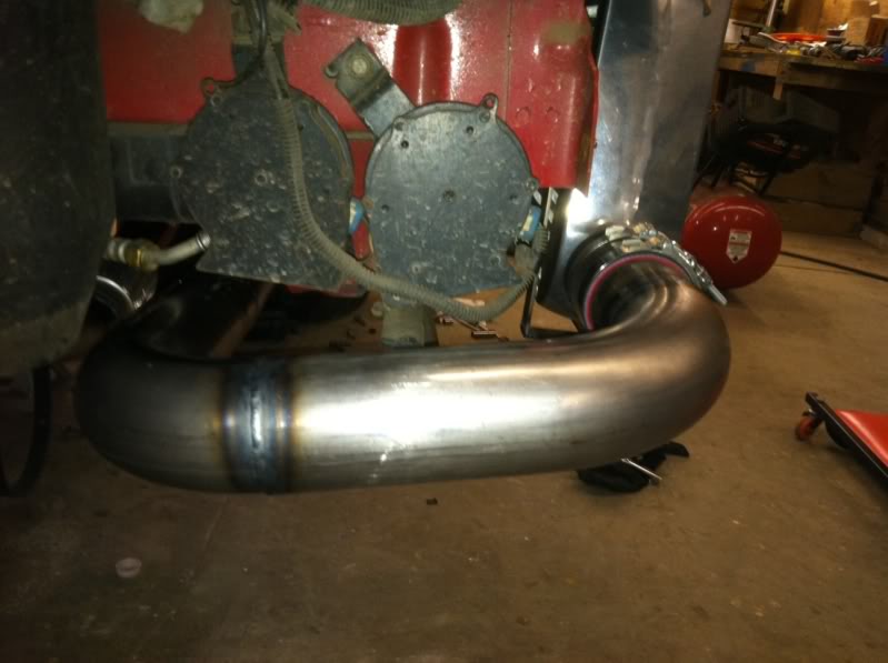

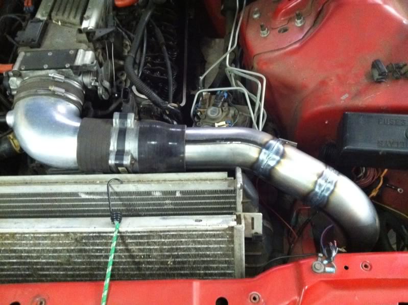

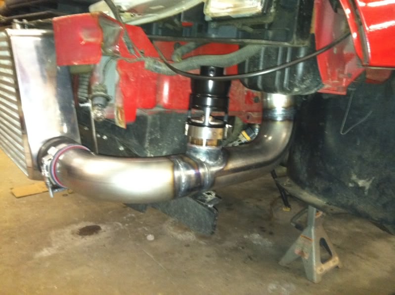

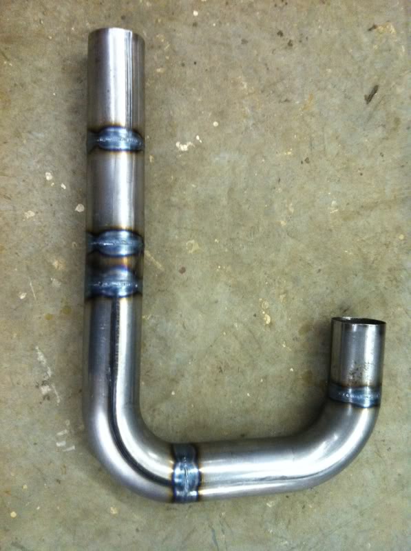

Kit is pretty much done (fabrication wise). Just waiting on the turbo and miscellaneous fittings.

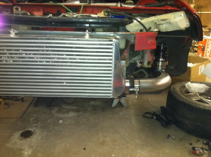

Jon
