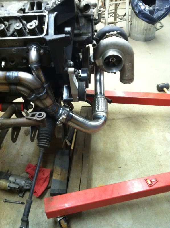

mocking up wastegate

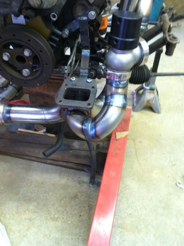

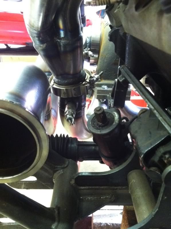

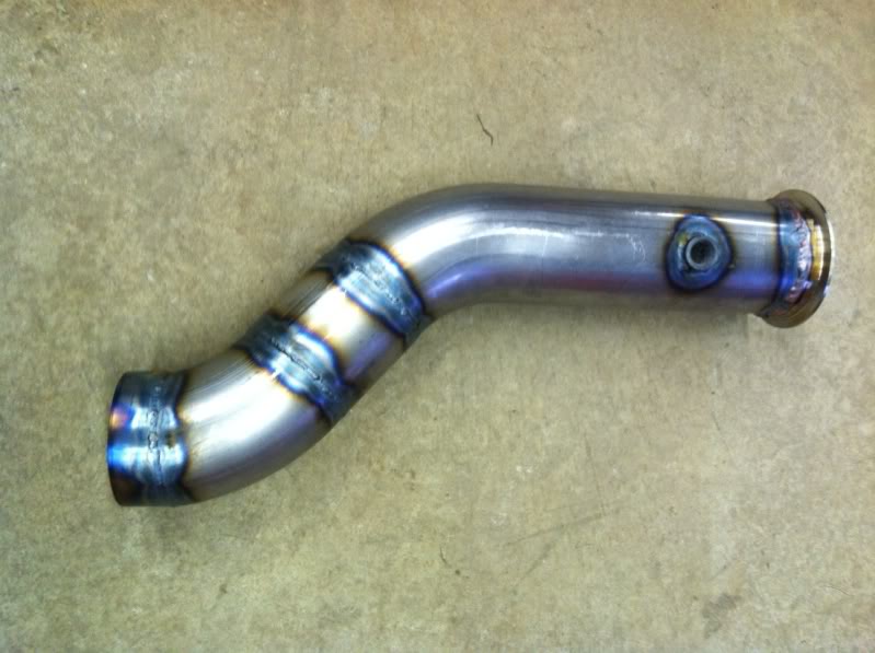

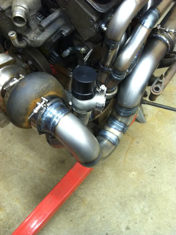

Wastegate inlet completed. Customer is gonna have it vent to atmosphere. I need to fab the dump pipe still.

Stock pass o2 sensor placement

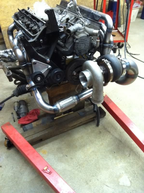

Stock Driver side O2 and showing space between steering shaft and DP

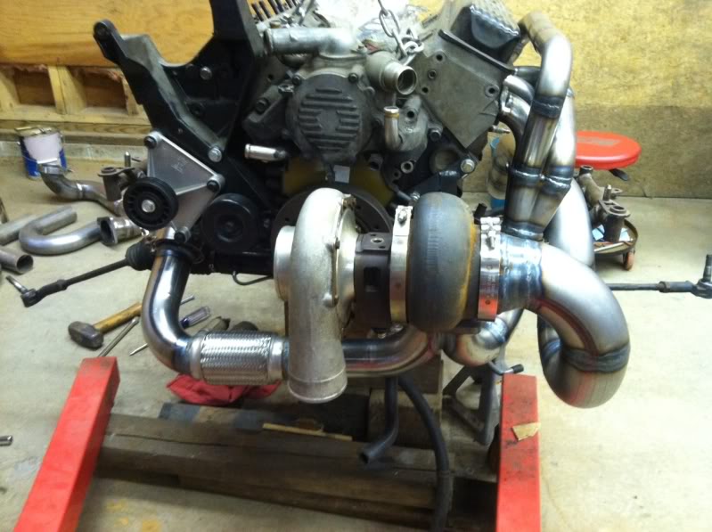

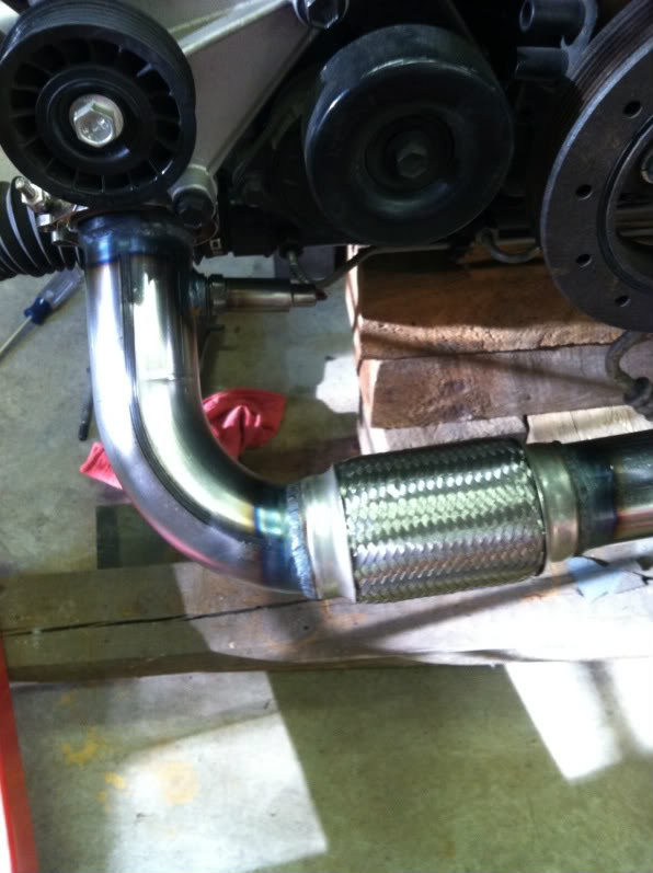

Looking good! What is the purpose of using the flexible exhaust piece? I saw in another thread, you replace the insides with a solid piece (or maybe it was ribbed....for her pleasure ).
Old Oct 24, 2011 | 03:57 PM
  #26
RealQuick's Avatar
Joined: Feb 2002
Posts: 5,645
From: Bridgewater, MA
Re: LT1 Boost PT88 Build
LOL!
The flex piece serves 2 purposed:
1) to allow for each side of the hotparts to expand/contract at different rates, thus reducing the chance of a weld breaking.
2) also allows for slight misalignment, and still be able to bolt together.
In the other thread, the mesh I removed on the inside just covered the ribs.
