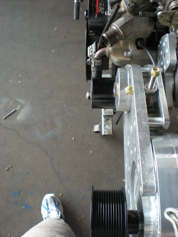

UPDATE!!!
Finally some serious progress! I've got a few little things left on the engine before it's ready to go in. Going to try and finish up the fuel system tomorrow, then hopefully get the transmission put back together on Thursday. My goal is to be able to at least turn it over with the starter this weekend. Hopefully be ably to start it up. Don't have exhaust for it yet, but the catback is on order. So is the Snow Performance methanol kit, hopefully they'll both be here next week.
As you can see in the last pic, I've gotta space the supercharger bracket out. Took measurements earlier and will have those made tomorrow at the machinist. Get those back tomorrow evening and everything should line up like it's supposed to.
School is coming up fast but I think I finally have a shot of actually being able to take it with me this time. We'll see

Where did you get that bracket, running the F1A aren't you??? Thought the standard bracket would work???
I have my ways mwuhahahahaha
actually, it's an SBC universal bracket. Since this is going into a '92 Camaro the standard LT1 and L98 brackets won't work. Had to do this to keep the blower up high. Made an adapter for the crank pulley to be able to attach it to the LT1 balancer.
