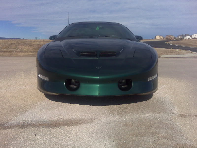

Mines a 4" intercooler...didnt want to cut the bumper.. IAT's are nice and cool.
Mine was the same... good IATs soooo.. no needto hack everything up. Tho i think iat's could be even better if you did
