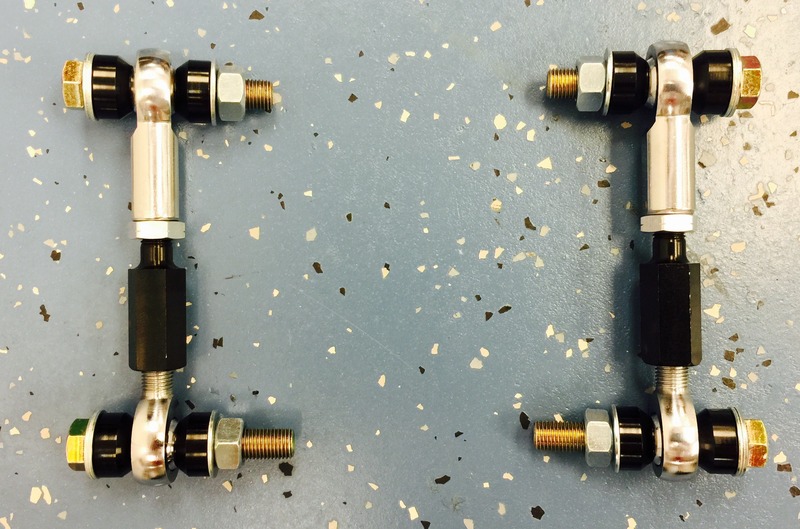

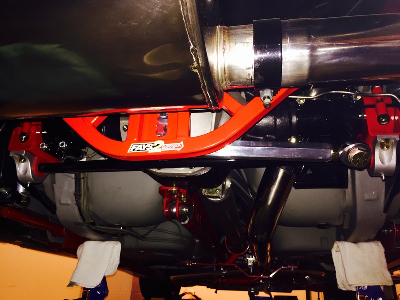

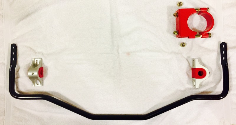

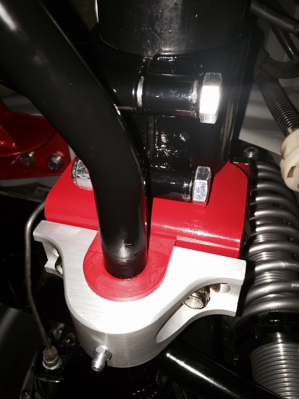

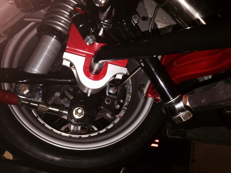

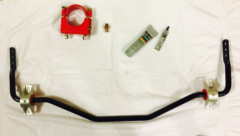

So, finally got around to upgrading my rear bar & sway bar brackets. I originally had the Strano 22mm hollow fixed bar on the car; along with the matching poly sway bar mounts & poly endlinks. I decided to do a small upgrade and just see how a Strano 22mm hollow 3 way adjustable rear bar would help the handling of the car. I also changed out to the BMR rear sway bar mounts, UMI aluminum/poly sway bar bushings (Front & Rear). The front bar is a 35mm Strano also. The BMR large heavy duty sway bar mounts are very nice pieces; however, make sure you have enough room to fit these beasts. I have a fays 2 watts link and it was a little tight trying to get everything to fit, but I eventually figured it out :nod: I also changed out the strano stock endlinks to a custom built set of QA1 rod-ends with an aluminum adjuster for changing the length of the assembly, as needed for the different positions on the bar. The whole setup is pretty trick and the bar tucks up nicely with my 12 bolt / TA girdle. The front 35mm Strano accepted the UMI aluminum / poly mounts no problem. Everything was greased with super-lube and mobil 1 red synthetic. I also removed my BMR extreme LCA's and replaced them with BMR's Poly/spherical (QA1) LCA. This should help the car out some; previous LCA's were poly/poly. I just need to button up a few things and take it out for some fun imp:
QA1 rod-ends with the aluminum adjuster/mis-alignment spacers (aluminum).

Just made it right here :nod:
You can see the BMR LCA with spherical end in this pic.
