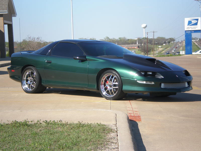

here is mine, its for sale too! cooler, piping, hoses, tbolt clamps and bov flange.

All of these look great! I haven't made my mind up how I'm going to mount mine yet, but I was wanting to do some sort of screen over the hole in the bumper cover to help prevent rock chips, etc. to the intercooler. Any thoughts?

Originally Posted by MikeGyver
I personally think that would look tacky. It looks badass with a big open scoop, it's like a jet engine. I could throw baseballs at my intercooler and not hurt it, it's tough as hell. The runners are extruded "tubing" unlike a radiator.
Doesn't look tacky to me. I have a grill on mine. Wouldn't want it any other way.
