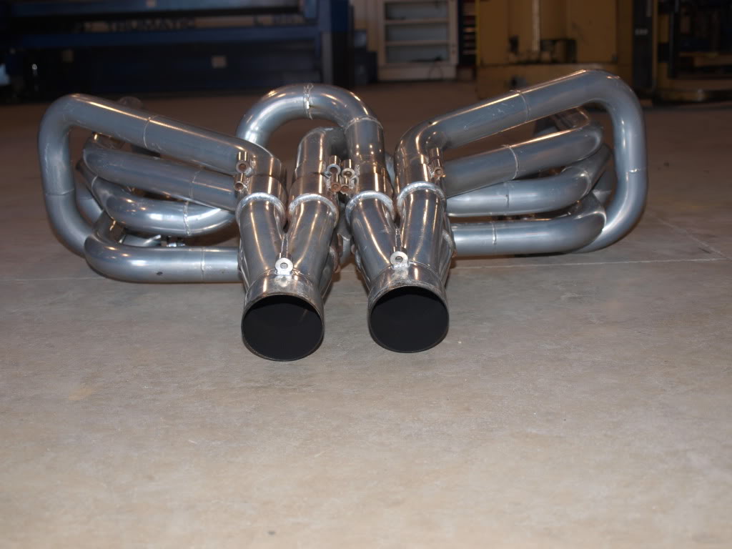

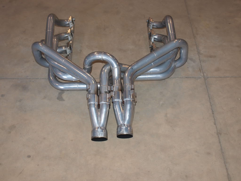

There are usually A/B tabs that are welded to the collector and primary. You then slip the collector over the primary and bolt the two a/b tabs together.
You should be able to see what I'm talking about in these two pictures:
Realistically you cannot get a 100% leak free seal with that style collector. In order to get a full 100% welded collector you would have to go with a formed collector with a welded diamond that connects the 4 primary's. We sell them and can be seen here:
