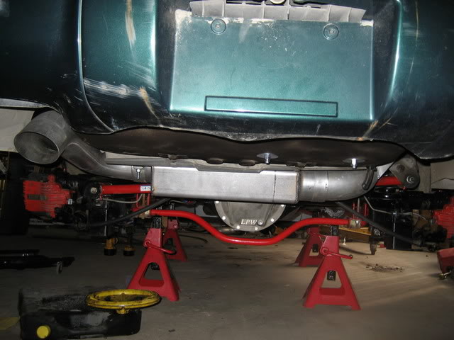

I have the single 4" system, with the single out Spintech. I guess Im lucky, fit perfect the first time and have had no issues with it working loose. Love the sound and the flow.

I'll have to view the pic when I get home. Is it an underside shot by chance? I'd love to see how it's mounted.

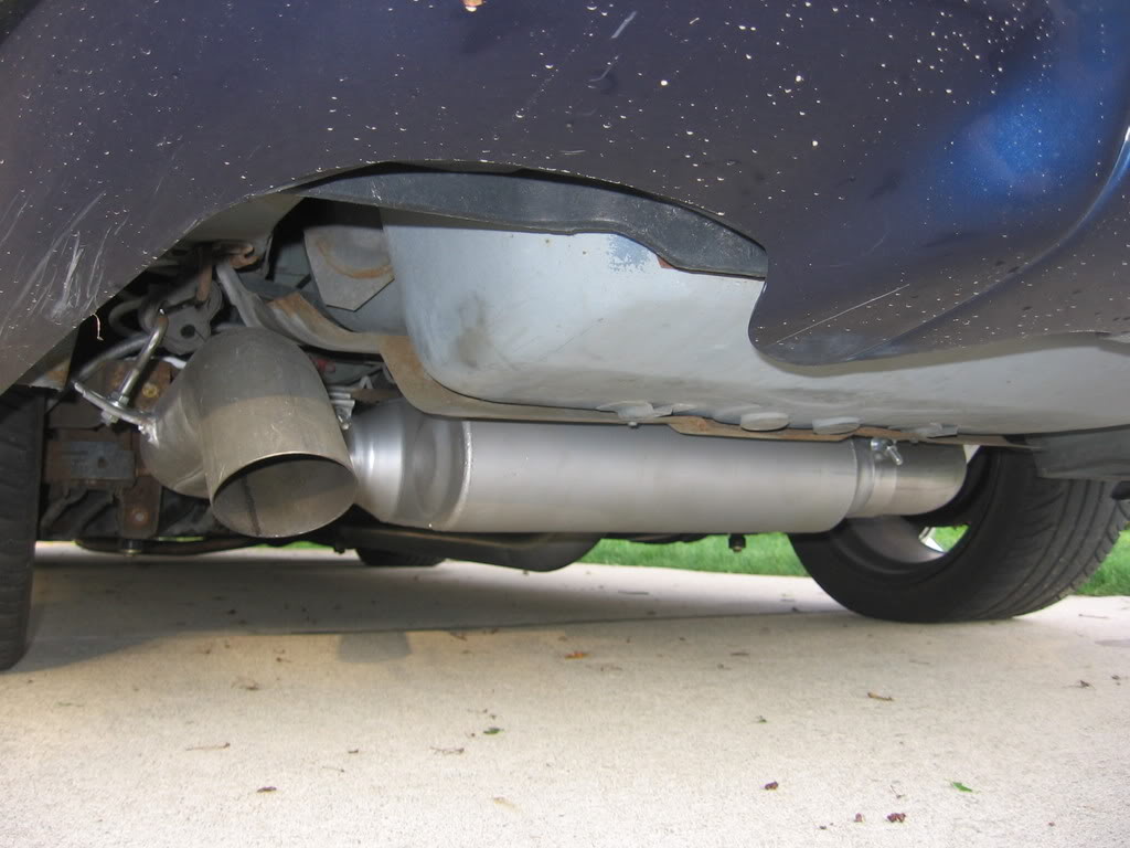

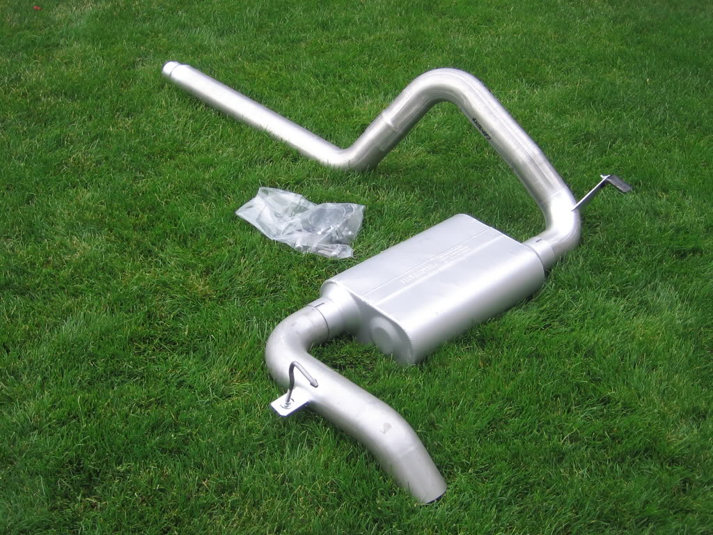

SRZ
Not sure if this will help you but heres a shot of my Exhaust properly assembled Off the car before I installed it.

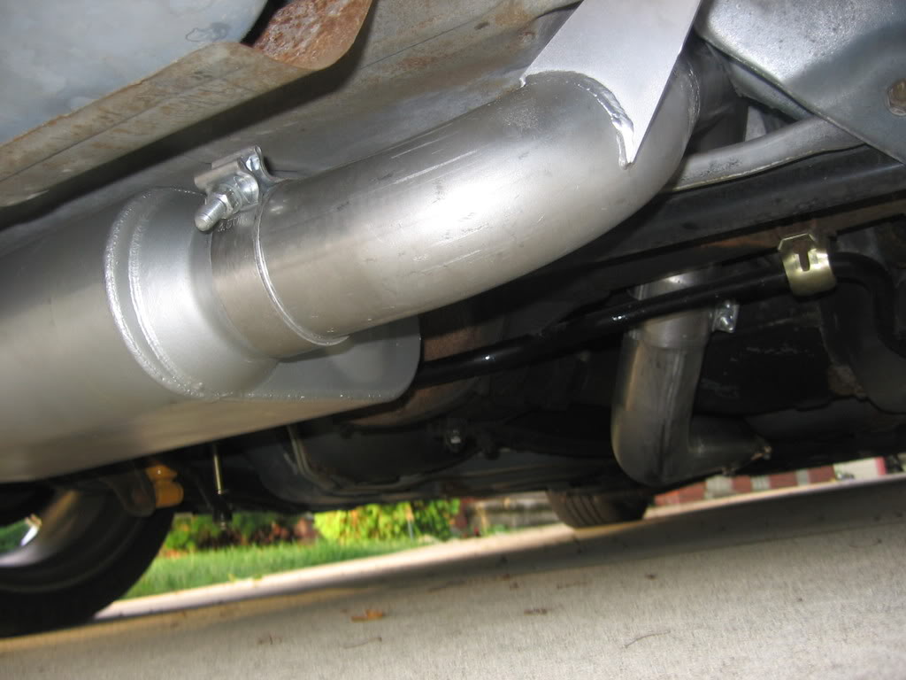

And a couple on the car right after install
No pics of it after modifications Sorry too Cold Now.

Thanks for those pics! Mine is just as long if not longer. I've got a friend coming to give me a hand in a week or so, so hopefully that'll be the ticket. Is yours a 4"? I swear my pipes look larger than yours. Your hangers are different too.
