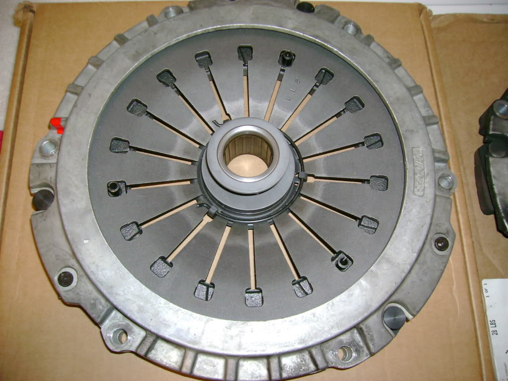

These are the numbers I'm getting off my Valeo Clutch kit pressure plate. This is not some other sellers kit, like AutoZone, but the Valeo kit. Do these numbers look right? I'm trying make sure I didn't get the wrong PP. The PP does have Valeo stamped on it.
382109-D0
187384 or maybe 167384.
These numbers look familiar?
My clutch guy says there number for the kit is K0082 HD. Any famliarity with that kit number.
Car is 95 Z28 M6
382109-D0
Car is 95 Z28 M6

OK, here's the pics.
I'm assuming the pressure plate that came with my t-56 was a stock replacement from one of your typical auto parts chains since it was a Valeo PP and the clutch looked to be fairly new.
The pp tha came with the Ram Clutch is on the left and the Valeo pp on the right
[IMG]
[/IMG]
Closer shot of the Ram pp
Closer shot of Valeo pp
[IMG]
[/IMG]
The pp that came with the Ram clutch had absolutely no material removed for balancing when I got it out of the box and was out of balance by 14 grams. Here are the spots where material was removed from the Ram pp by the machine shop during balancing.
[IMG]
[/IMG]
[IMG]
[/IMG]
The Valeo pp that came out had holes from the balancing process, so it was a balanced unit, but I cant say whether or not it came that way or if it was balanced by the previous owner. Also note that the Valeo pp needed less material removed to be balanced, there were only 3 drilled spots on it as opposed to the 5 spots they had to drill out on the pp that came with the Ram clutch. Heres pics of the balancing spots on the Valeo pp
[IMG]
[/IMG]
[IMG]
[/IMG]
After closely inspecting both units they appear to be virtually identical except for the valeo name casting. If you buy a clutch kit and it hasnt had any material removed for balancing, I would either return it or have it balanced.
