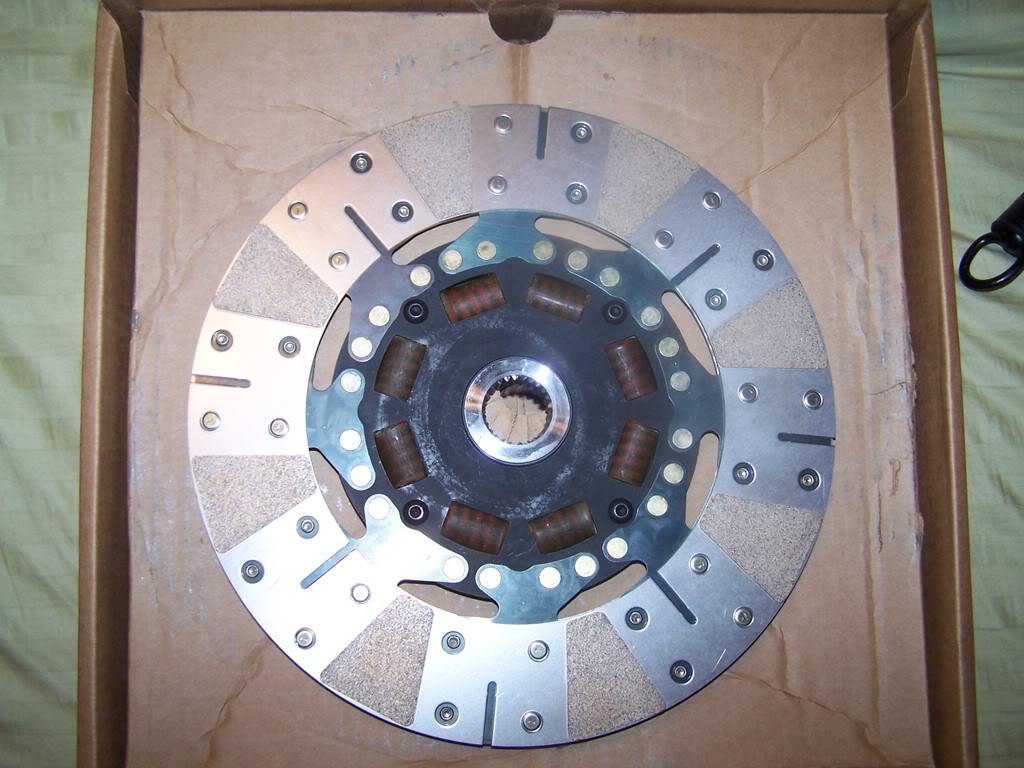

Just thought I would say my ram powergrip HD pressure plate doesn't say valeo anywhere on it. Not sure how it compares to the valeo but it looks just like any other LT4 pressure plate that I have seen. It has also been completely deburred and it has also been balanced.
And a few other pictures of the powergrip HD for this thread. The mcleod single disk I'm running wont hold launches on nittos with my power level so I'm swapping it out.

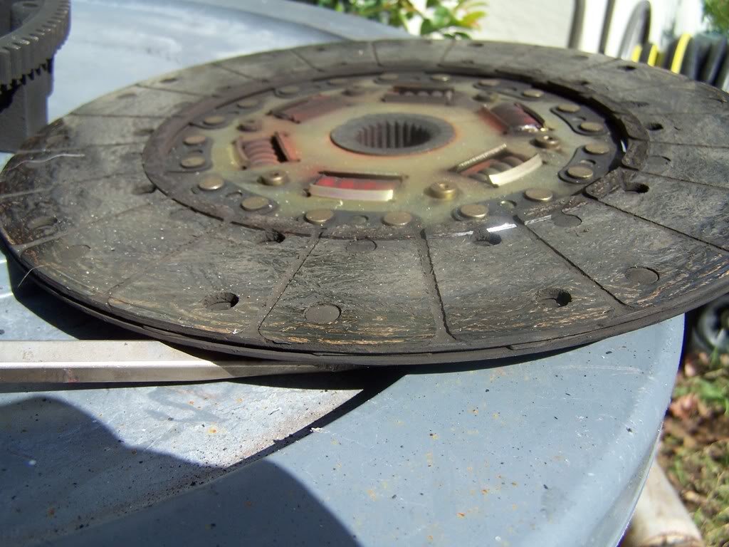

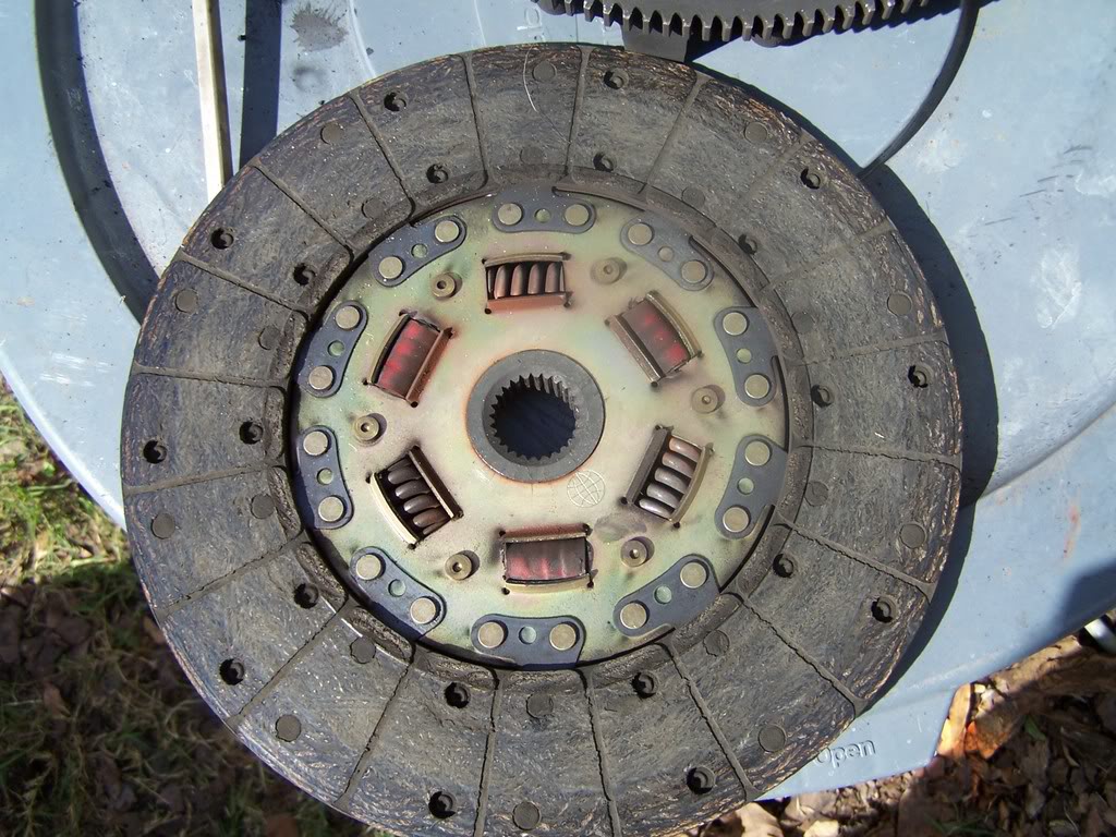

Heres some pictures of the mcleod single disk that is so popular. You'll find out why I'm not a fan of duel friction clutches in the pictures. This clutch had < 30k miles on it too.
