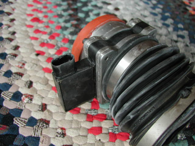

The MAF housing is cracked;
LT1 MAF crack.
It doesn't seem to affect how the car runs, there is an idle problem, missing and sometimes backfiring when you crack the throttle off idle but the EGR is leaking though. I got a new EGR valve coming and will see what that will do for that problem.

Just to follow up, I put a new MAF on and it is much crisper during a rap of the throttle. Datamaster shows more airflow during these throttle blips, the missing and sometimes backfiring is completely gone.
