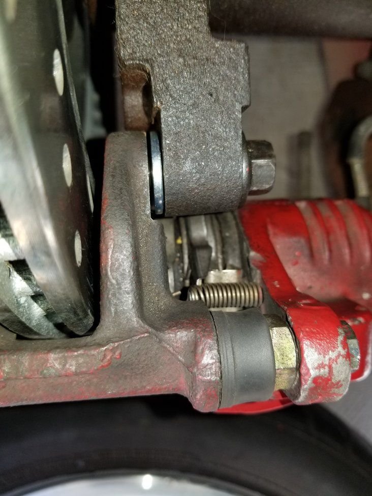

i did the M12 washers too.. it did take care of the loud squeeking sound.. but i still had the grinding noise (not much)..
just now i decided to remove the M12 washer and insert it on the bolt next to it (holding the caliper).. and guess what? noise gone.. caliper right in the centre.. and little to no end play..
took it for a test, full circles and tight turns, no noise what so ever.. give it one last shot and hopefully it will work for you too..
P.S. i used one washer only, on the top bolt.. maybe you need to have them on both bolts.. check first..

i inserted one washer before the golden nut.. this isn't my picture.. i didn't get a chance to snap one..

so you installed the washer where the caliper bolts to the bracket? what i did was install two of them on the bracket but that just brought the bracket closer inside. i even grinded the little rust off the rotor where the pad was catching it. once i take the cover off an the seals out of the axles an inspect the bearings ill try the one washer in the actual caliper. i dont think my caliper pins are bad either . they slide fine an have very min play in them.
