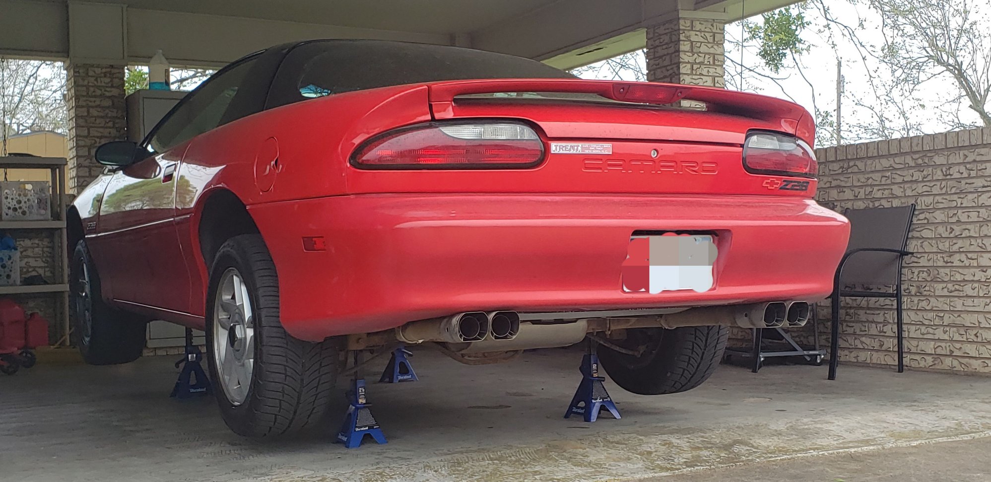

Hi all,
I'm going to replace the clutch kit, RMS, pilot bearing, and slave/master cylinder. I'm planning on getting a low profile transmission jack, but wanted to know minimum clearance to see if my jackstands are high enough.
My jackstands are already near maximum.

I used 2 ton jack stands at about the height in your picture and was able to clear the low profile trans jack from Harbor Freight (removing the trans from the belhousing). I did need to jack the read end up from the pumpkin once the transmission was separated to clear the car.

when i swapped my trans i got the rear tires up on ramps and put blocks under the front pads. gave me plenty
of room to work and was able to roll the trans out

nice idea about the wood! You were definitely higher than me. I had to go up about 3” on the rear when I was ready.

You can build cribbing out of 2x4 to put under jack stands. You will need a block of wood on top of floor jack to jack the car up high enough. Basically with the car on stands front & rear then using the block on the floor jack raise front and put the cribbing under the jackstands. Do the same for the rear next. The HF tranny jack works great. Pull trans from bellhousing first then remove BH & clutch after
Use the floor jack with block of wood and a folded towel under the oil pan to support the engine so its not just hanging by motor mounts after pulling x member
