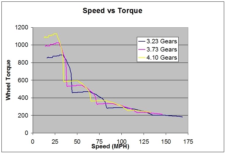

Here is a graph I made a while back showing the differences in gears...
