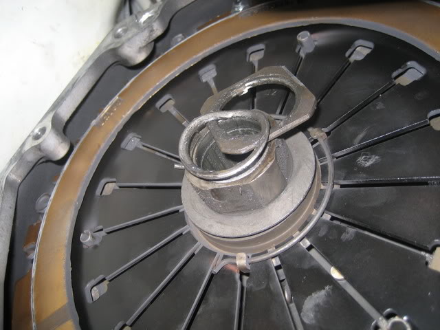

WRT the throwout bearing. When one goes bad it just makes a lot of noise or in the case of me, this happened a few weeks ago:

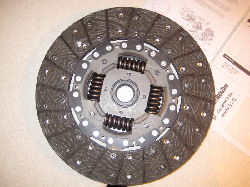

This is the disc. It's a brand new stock replacement type.
I'm still not understanding why this isn't working. If the PP is the same and the disc is good, what else could it be?

Again its the disk as it relates to the compressed vs. uncompressed specs. Get these two diminsions from the disk and subtract the smaller from the larger. What ever that new measurement is, your clutch does not provide enough clearance and the disk is dragging. You have to compare this against a known good disk.
That is NOT a GM disk, it is most likely a cheap Chinese knockoff. The GM has five damper coil springs in the hub.
Assuming the hydros are working correctly, you will need a different disk or and adjustable MC. I chased this problem for weeks many years ago.
I'm almost positive it's a duralast brand clutch.
I ordered a SPEC stage 1 kit today. I wanted the S2 but this surprise need for a clutch already tightened my budget up for the next couple weeks.
Hopefully it holds up OK.
