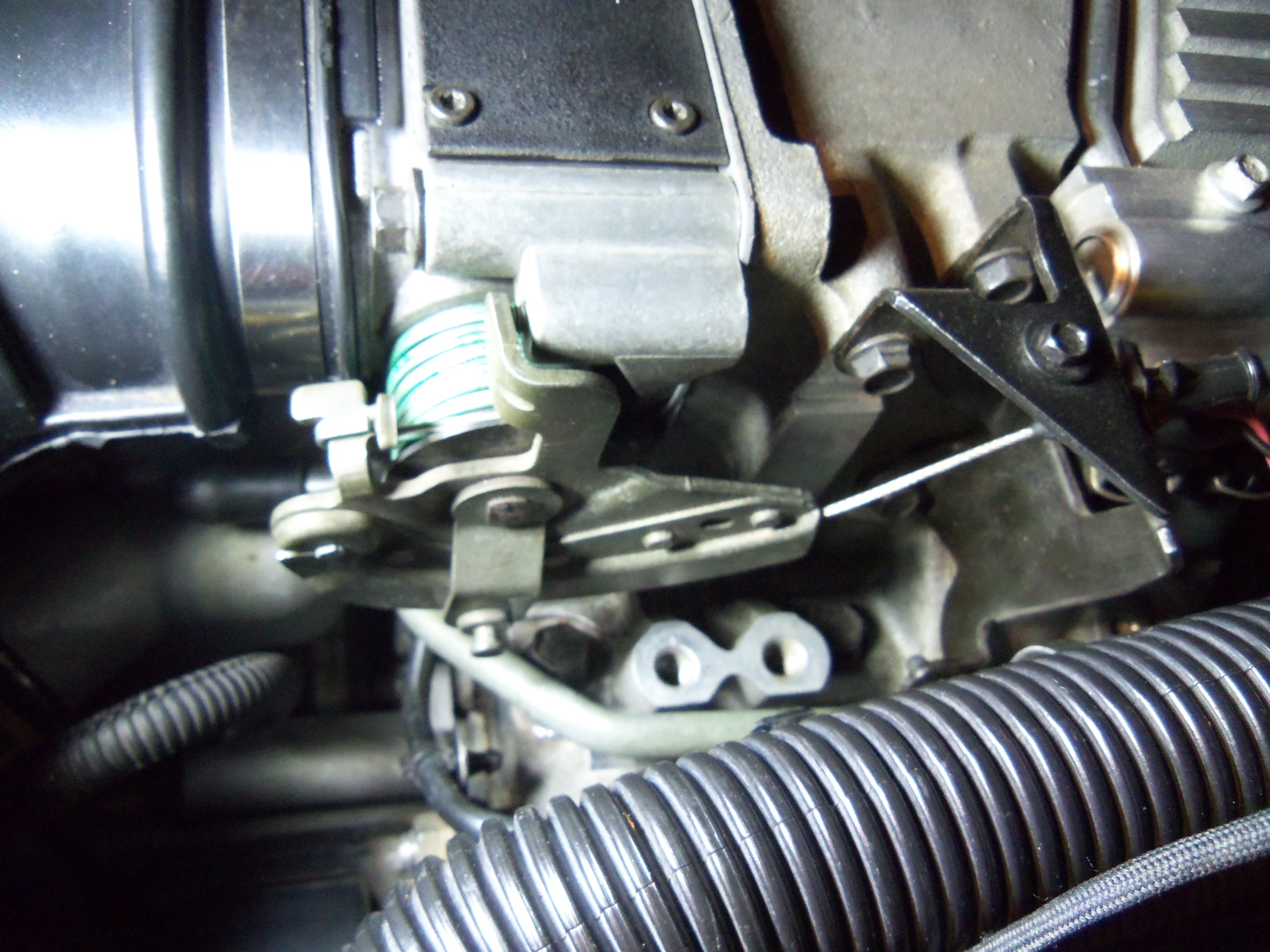

I put everything back together and the car started right up.No dash lights,codes,fires,all ok.Car seems more responsive.Left the foil off.The second from the top cable has about 1/8 inch play at the end of the cable when the tb is closed.Wonder if that matters?Thanks for reading.

I am a little confused. The second from the top cable has about 1/8 inch play ?
My throttle body only has one cable going to it, does yours look different than the one in the picture ?
When my throttle body is closed, there is NO play in the linkage.

Maybe yours has 2 cables, and one of them is for the TV (throttle valve) which affects the transmission shifting ? I don't really know. Injuneer would most likely know for sure the what and hows of it. Wish I did know, sorry.
Old Jun 12, 2017 | 08:34 PM
  #55
Posts: 71,098
Re: Scan93
I think.....
93 auto trans has three cables - accel pedal, cruise control and TC cable.
94-97 ABS only car has two throttle cables.... one from the pedal and one from the cruise control.
95-97 TCS option attaches those two cables to the servo motor on top of the valve cover and runs a single cable to the throttle body.

Originally Posted by Injuneer
I think.....
Yes.
