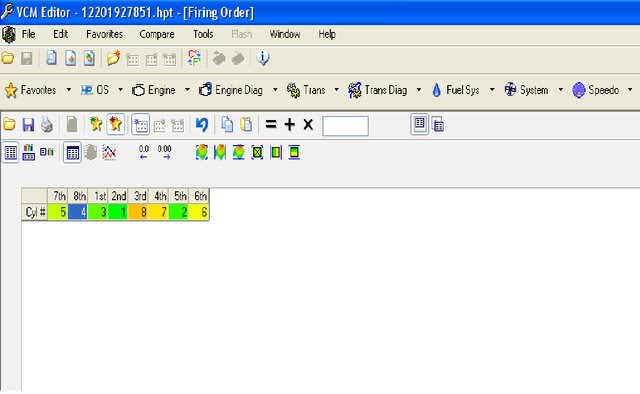

I haven't been able to find it in the program, but I have started a new thread over at HPTuners forum, so hopefully I can get something going. I did notice however that you could change the firing order on HPTuners. This could help with some of the conversion guys, either that or confuse them.

On HPT can you change number of cylinders?
Fast is good, no seriously, it is being overspun like a ****. I dont have the P#'s you might PM LittleRedZ, as I bought the setup from him. I just checked HPT on the # of cylinders, min val is 8, max val is 8, so it looks like a negative.

I always thought this was fixed, but I wanted to know for sure in case we could do a coil on plug for the typhoons and syclones... or other v6's.

As I was checking with a few people... That firing order ONLY affects Miss fire data. It doesn't affect the actual firing order. You would STILL have to wire the the outputs in the way that Mike @ Efi has done it... Just a clarification...
Yep, you are right.
Yea, I was reading the same thing while looking for the injector bank assignment. Supposedly HP Tuners has the table for it, but I guess it is a new development.
http://www.hptuners.com/forum/showth...=injector+bank
