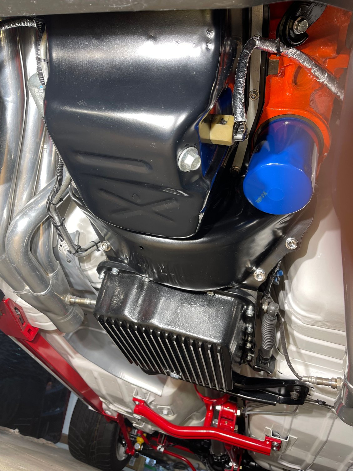

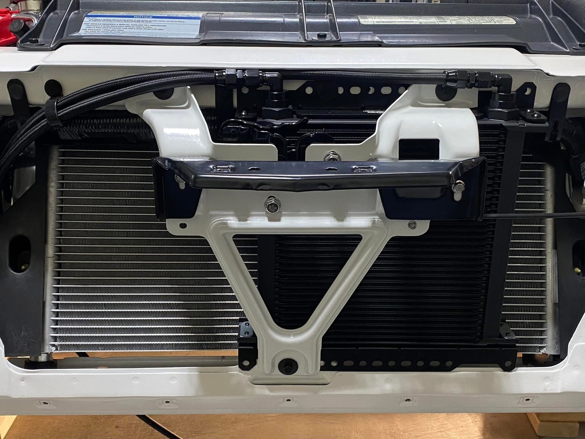

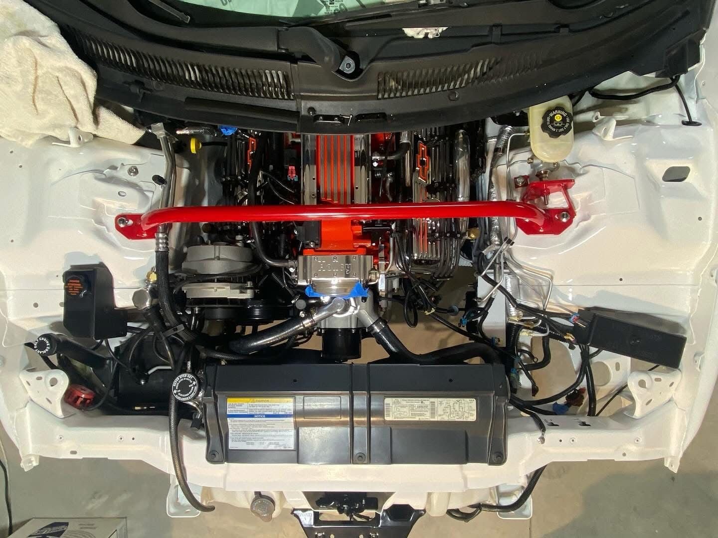

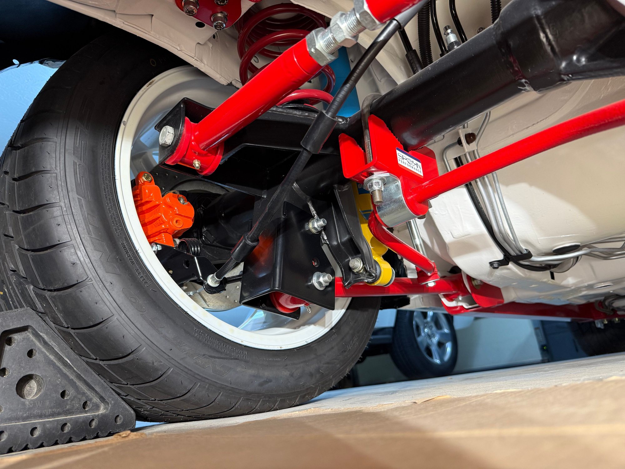

Well, I’m still at it! Slow but sure. Went several different directions than what I originally had planned. Have a BMR upper/lower A Arms, Meziere electric water pump to install in the water pump housing, a Dewitt’s 2 row aluminum radiator, new AC Condenser and last but not least an Earls Performance external trans cooler.
I also completely disassembled engine bay again and stripped/sanded down to bare metal, primered and resprayed the engine bay. I did this cause first time around when I started car was outside and paint didn’t adhere well and chipped off. Took two weeks of going at it to complete!

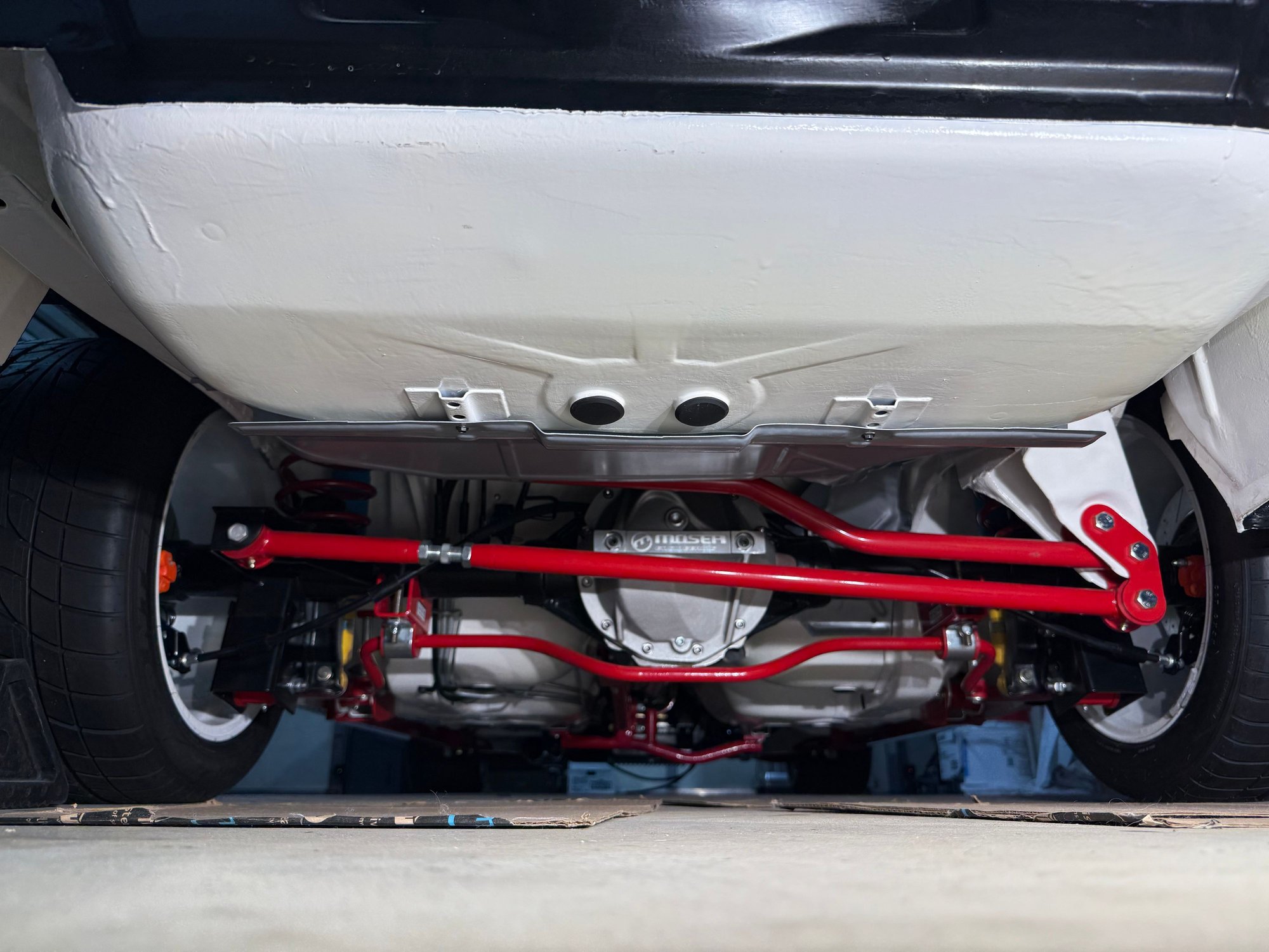

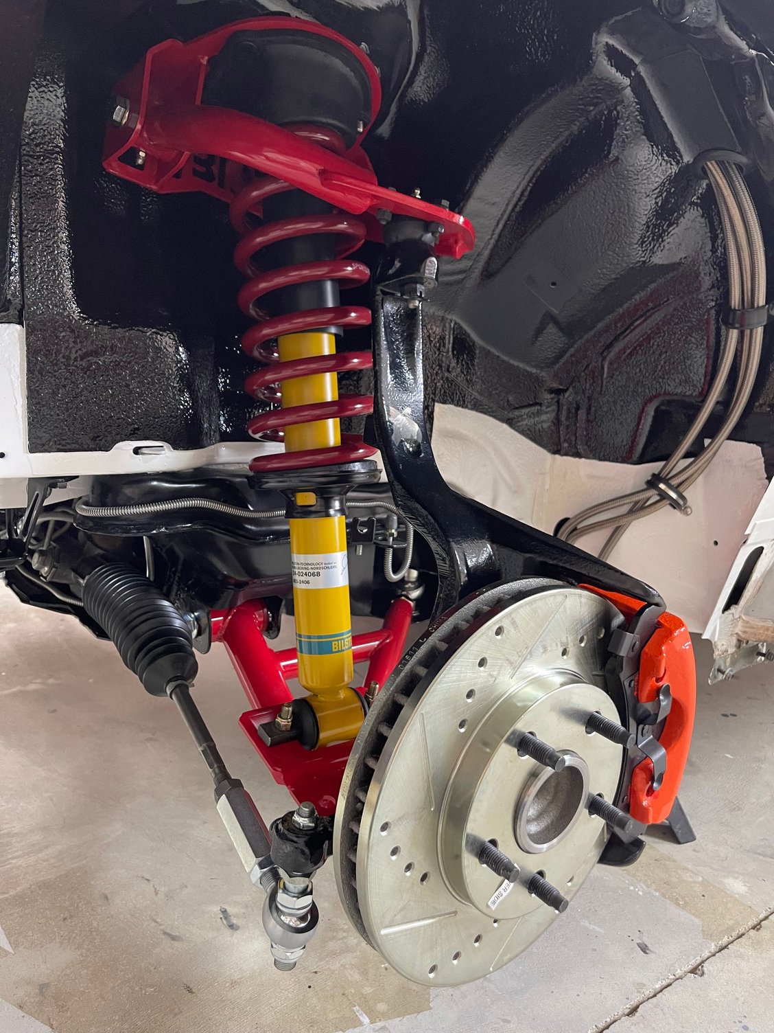

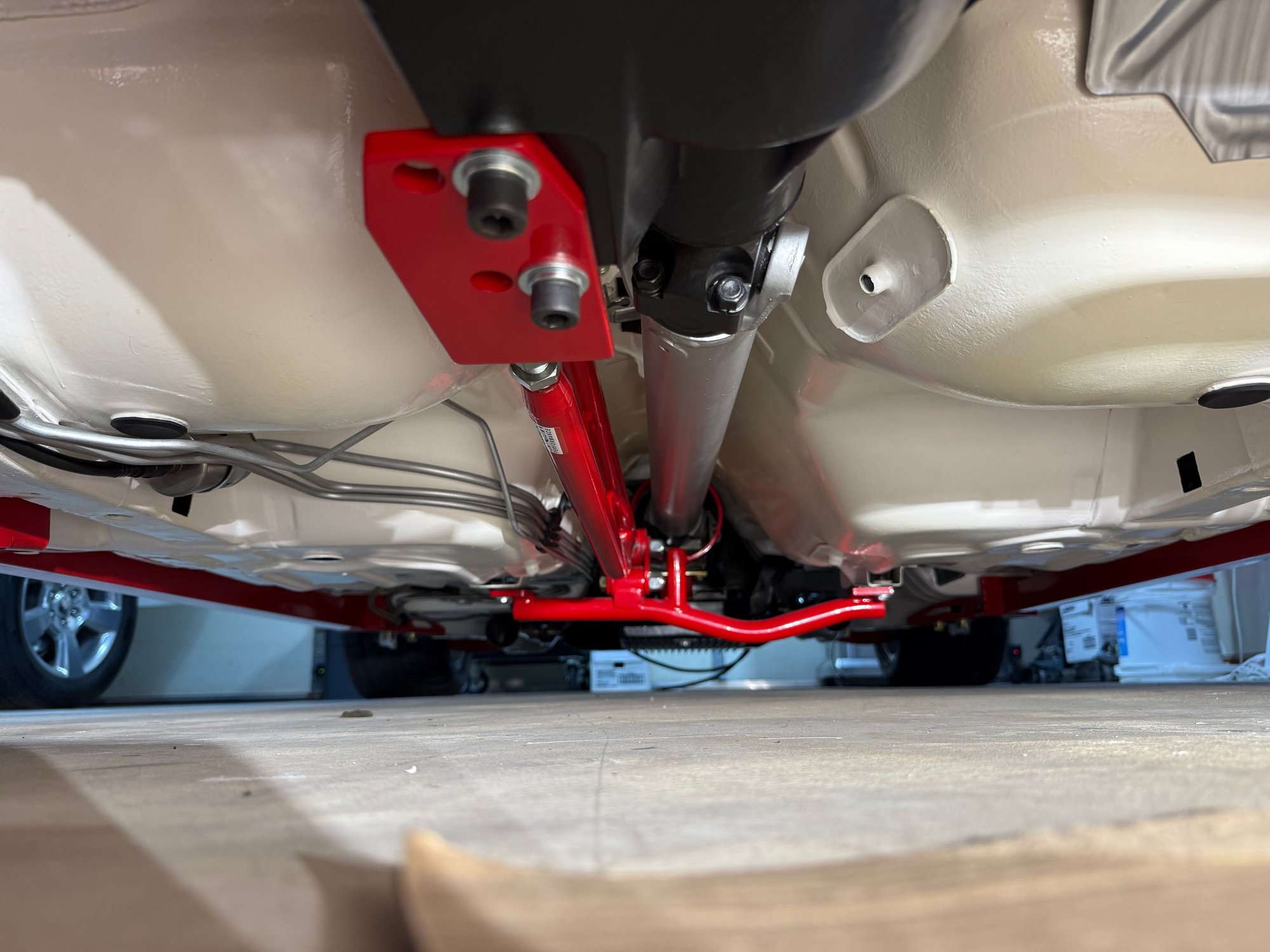

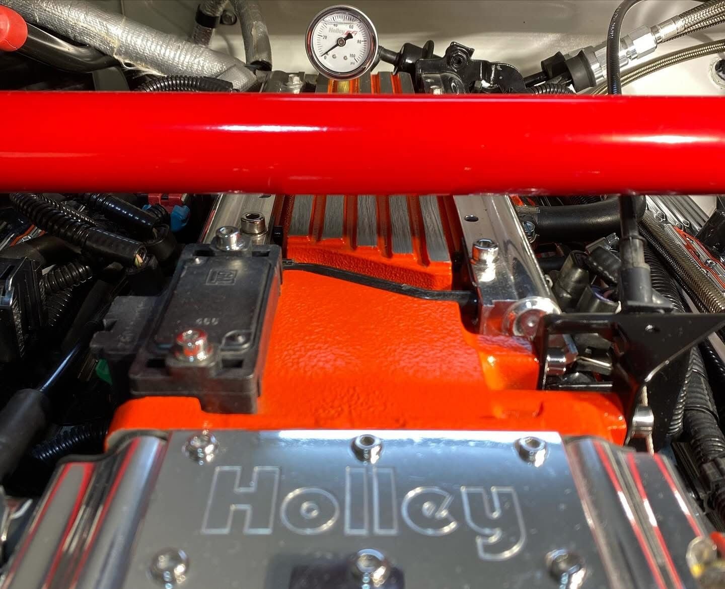

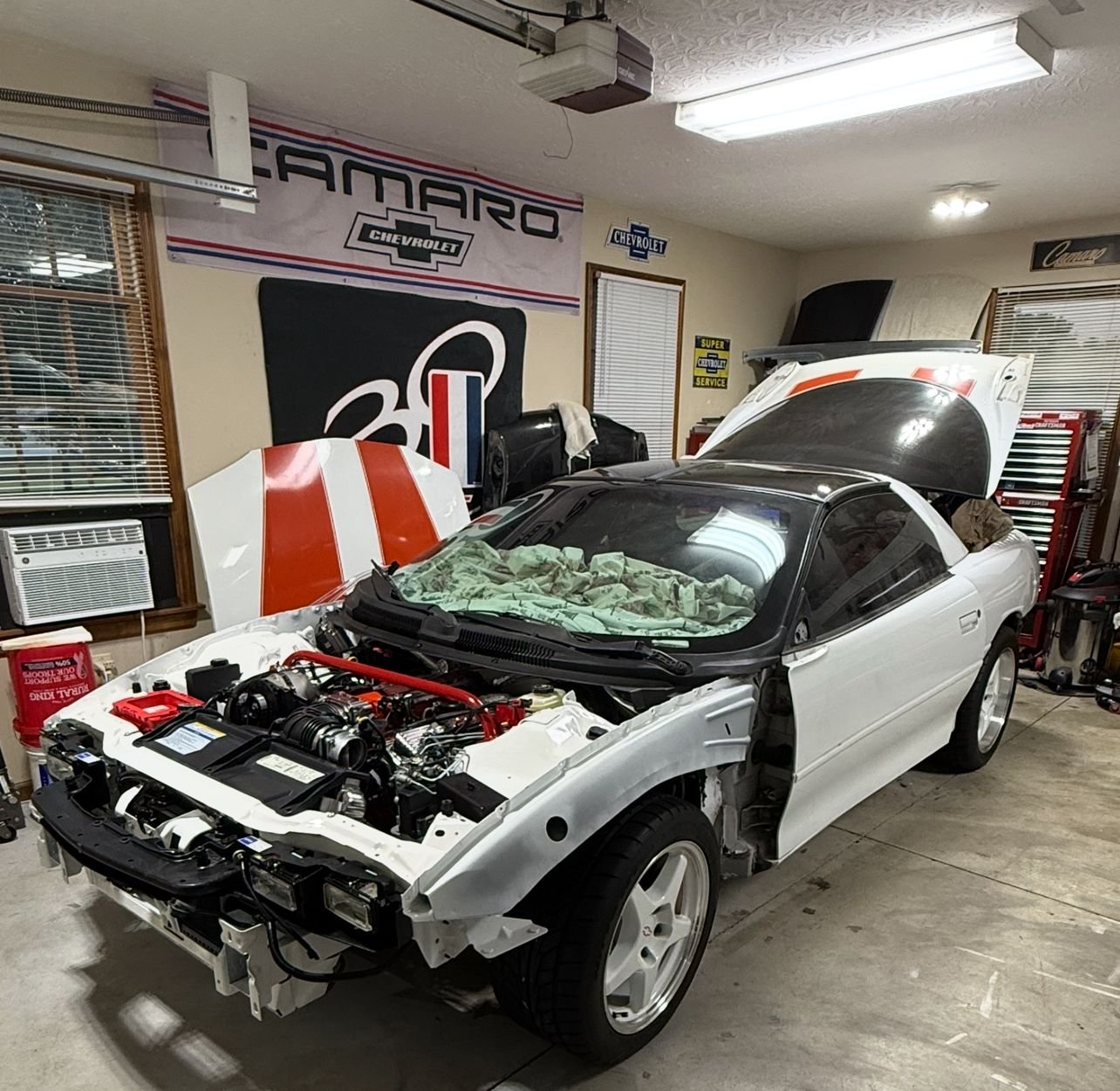

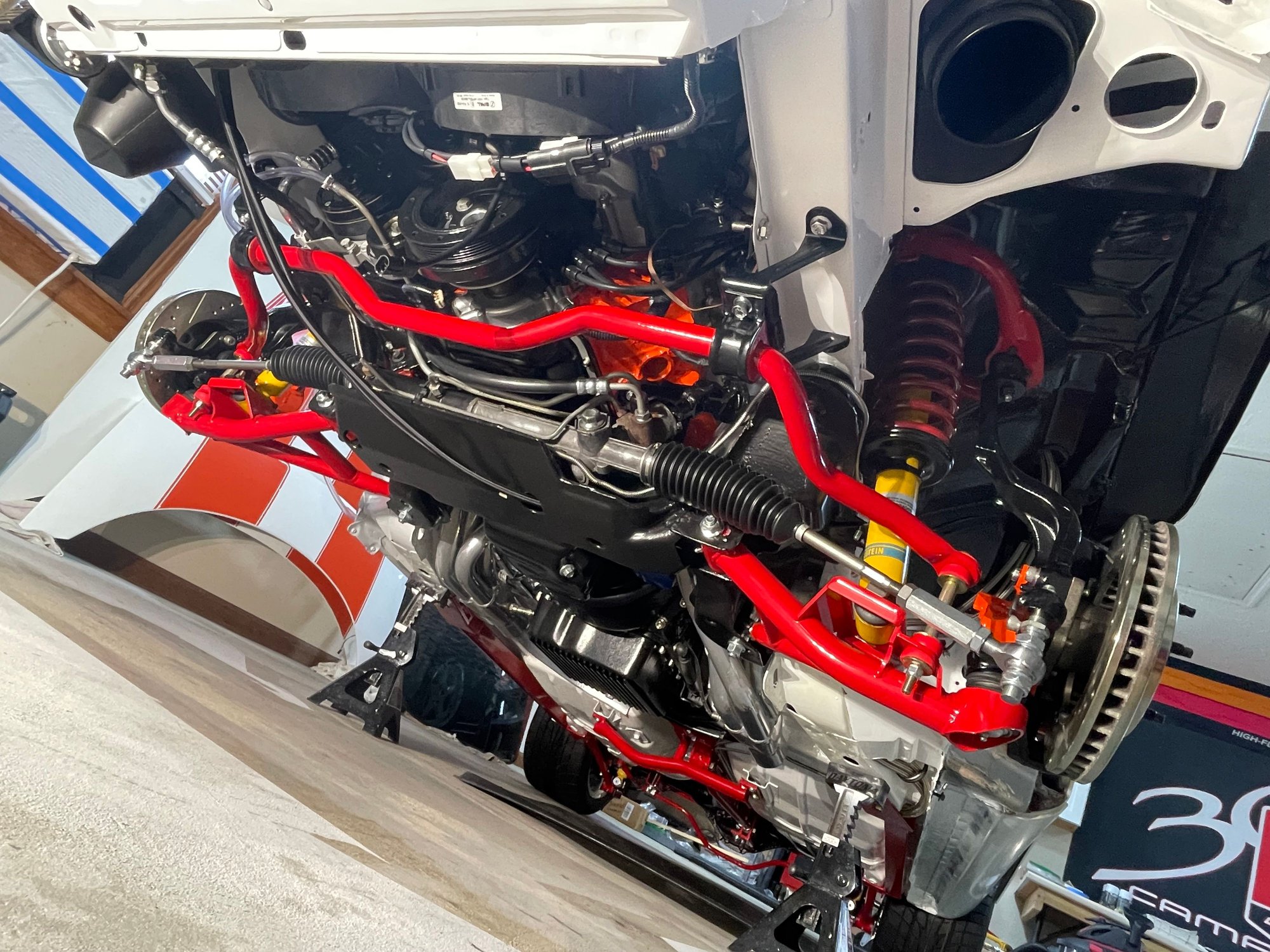

Appreciate the comments guys! I’m 62 and I ain’t quick as I once was. Be the last time I do this unless I have a lift. Climbing and rolling around under a car sucks the older you get. I have a ton of photos I need to post to where she is now.
ill try to post a few…

Amazing work - so impressive.
Every price is a work of art.
When will the start up be?
