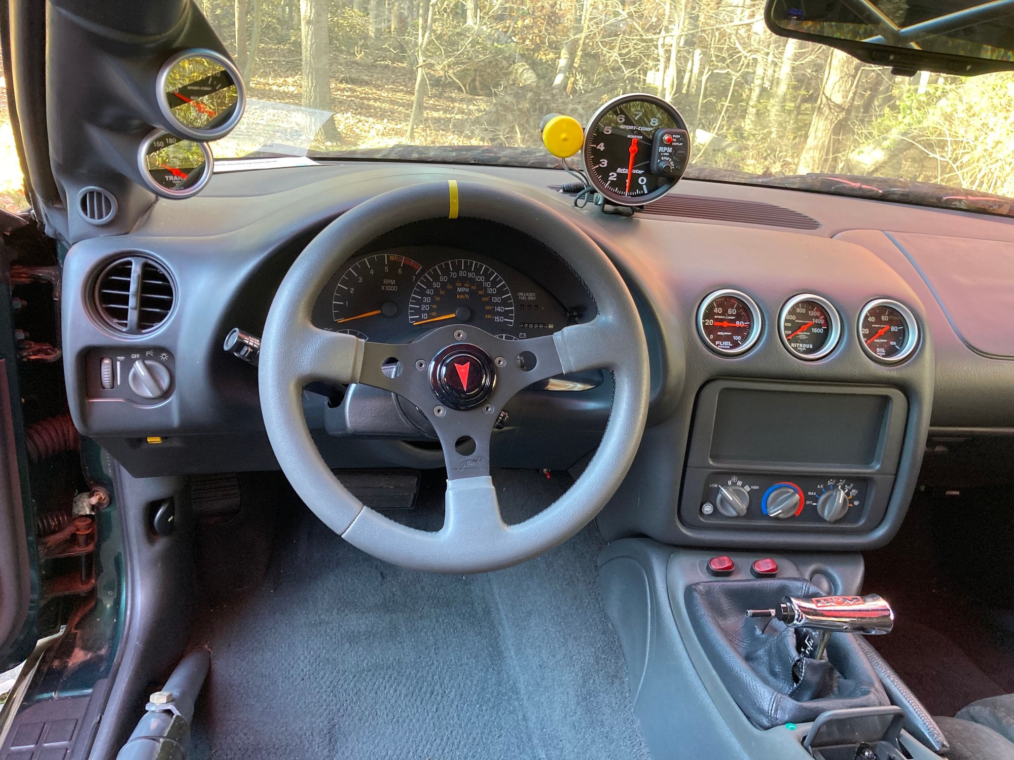

I put a Grant wheel on my 94 Formula. I used the Grant install kit for a 3rd Gen Camaro.
I may have the kit part # somewhere in my garage.

Google AI…… for the kit I used:
Yes, the Grant 3196 steering wheel installation kit is designed to fit a 1988 Camaro
. This kit is compatible with a range of GM vehicles from 1969 to 1994, including the 1988 Camaro, and includes the necessary die-cast hub and hardware for installation.
  • Vehicle compatibility: The Grant 3196 kit is explicitly listed as fitting the 1969-1994 Chevrolet Camaro.
  • Kit contents: The kit includes the die-cast hub, hardware, and trim pieces needed to connect an aftermarket steering wheel to the Camaro's steering column.
  • Important note: This kit is for vehicles without an airbag or for those where the airbag is being replaced with a non-airbag steering wheel. If your 1988 Camaro has an airbag, you will need to take extra steps to safely remove the original airbag before installation, according to the instructions in the video linked,
