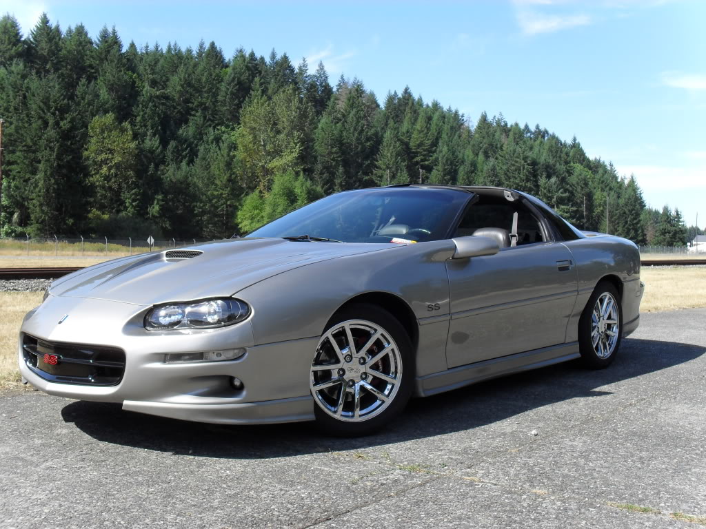

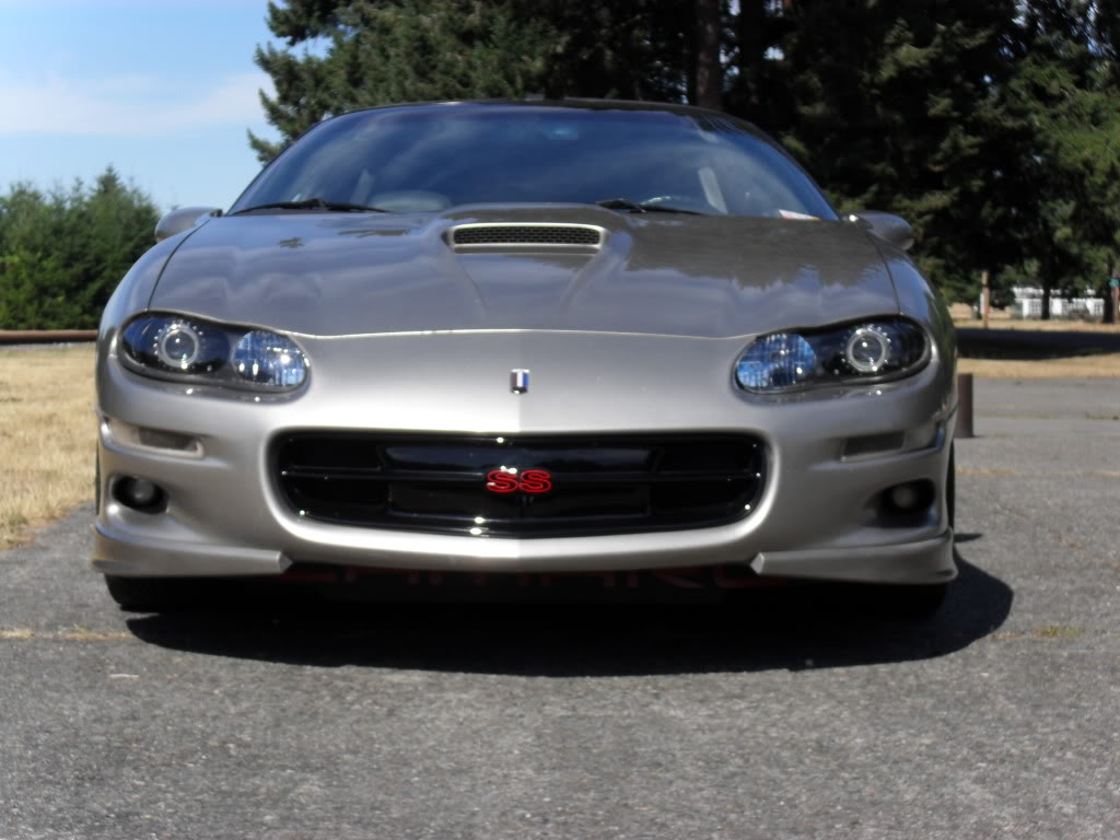

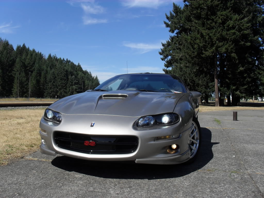

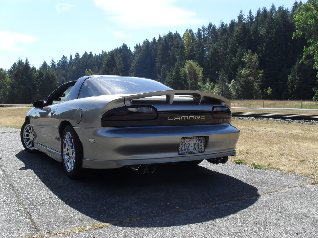

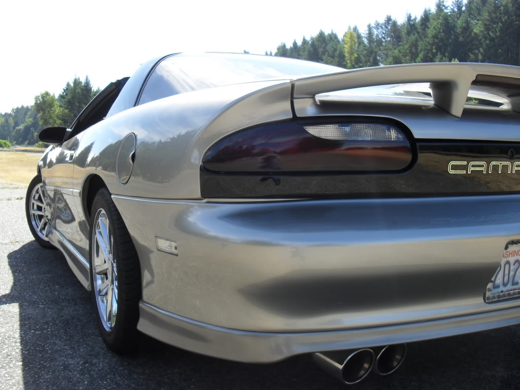

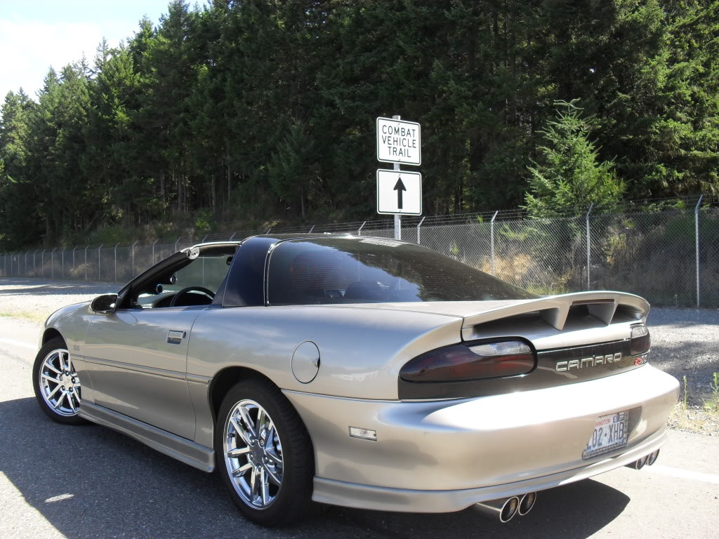

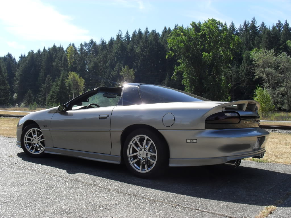

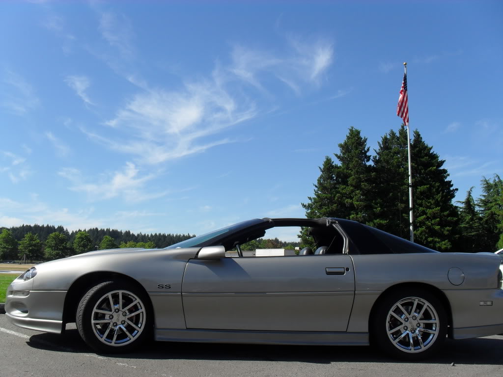

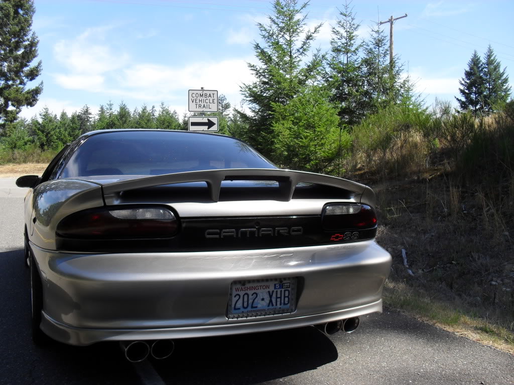

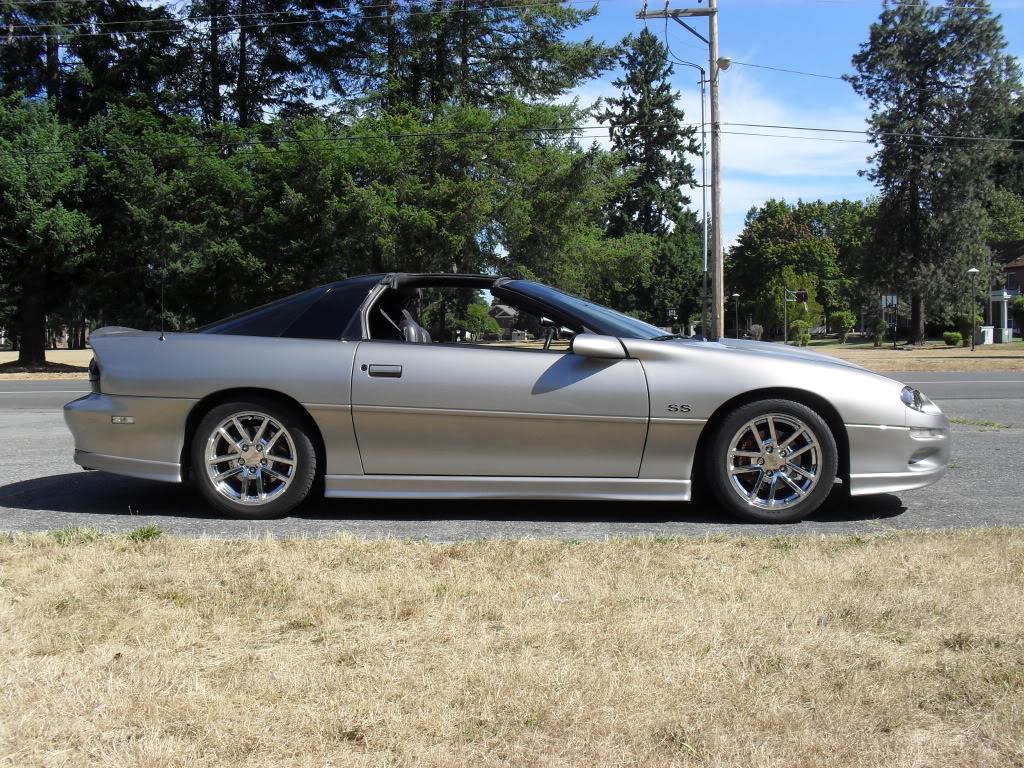

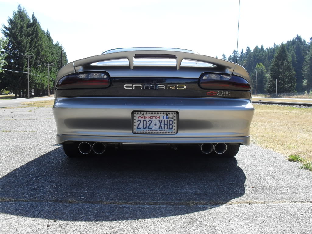

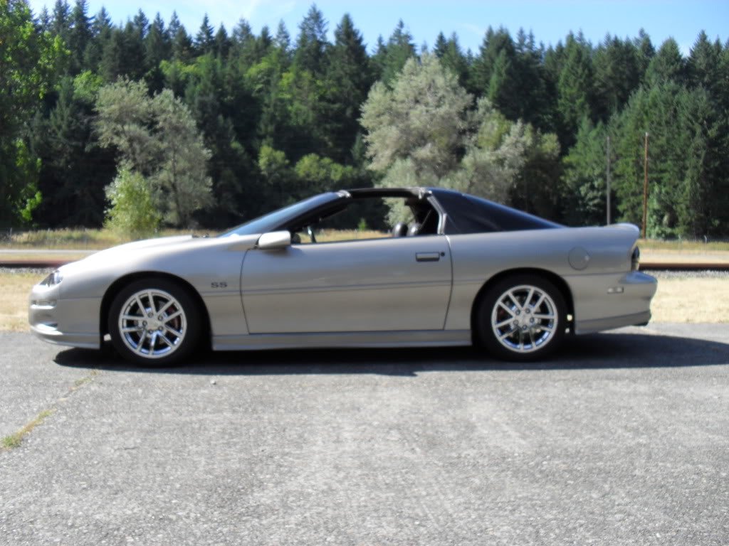

Well, I installed these about 5 days ago and all the fender wells measure about 26.5 inches from the ground except the passenger rear, which is about 25.5 inches off the ground, meaning its lower than the front, and the other rear side. The stranos and kyb agx were brand new. There is nothing heavy enough in the back rear to drop it that much, does anyone have suggestions? By the way, heres some pics..

Measure it again, with at least 150lb. in the drivers seat. How much do you weigh? It is completely normal for cars to sit low on one side, or one corner. If you want it level your going to have to put a spacer under the spring, or get the "Complete height adjustable coil-over kit".

where can I get that? Another guy recommended using washers to space it. Is that safe?
If you mean the Coil-overs? Stranos and others. If you mean spring spacers, do a google search under "spring spacers".
Yeah, put a person in the driver's seat and then remeasure. You're supposed to have a person in the driver's seat when aiming your headlights as well!

Did you check the spring isolaters? Did you make sure the springs are all installed correctly? (as in, are they all turned the right way?)
