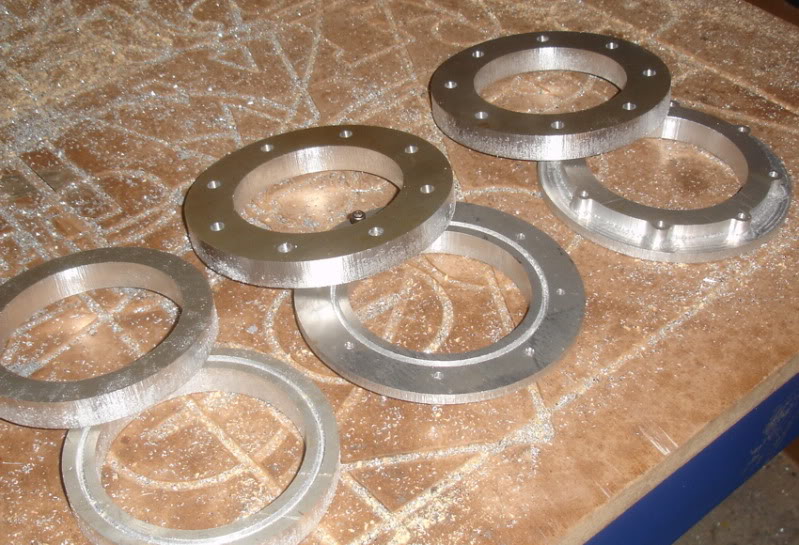

I'm ready to rebuild the firewall. I cut the flanges out today for the intercooler tubes to pass through the firewall. I'll turn them down on the lathe & weld them in place & shape the sheet metal around them.

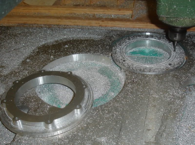

Got the flanges turned this weekend.
I put a groove around the edge of the flange for the firewall sheet metal. Once I install the o-ring and get in place I'll check the new gap with a feeler gauge and make a soft gasket to seal the flange to the firewall
Engine side of the flange bored to size for the tubes.
Got everything mocked up. The flanges on the windshield will be added to the inlet side. I'll turn those once I get the V-band clamp. Should be here any day. The outlet side attaches to the carb bonnet with hose & clamp.

I've been runnin' the lathe off & on the last few days & got the V-Band clamp flanges done.
Assembled and ready to TIG together
one more check to make sure everything fits like it should.

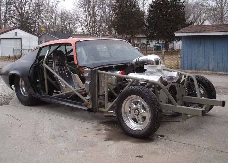

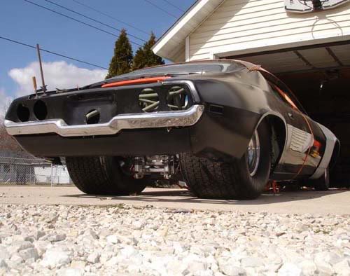

This thread is amazing. You sir, are quite the fabricator. Great work! That motor looks pretty sinister as well! What car is this going into, '70 Camaro by chance?
Old Nov 19, 2009 | 09:35 PM
pro70z28's Avatar
Joined: Jun 2006
Posts: 55
Thanks ReaperWS6. Yes, it's a 70*RS split bumper.
