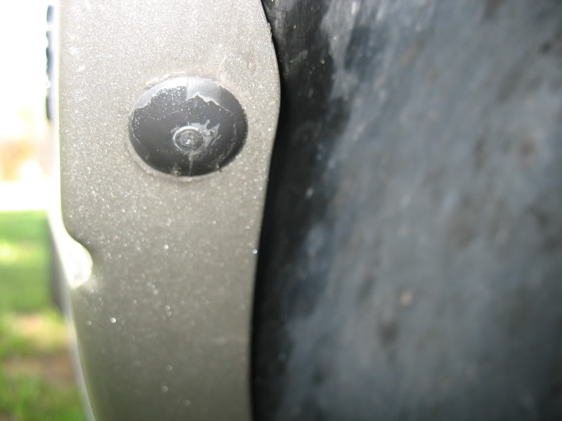

Finally got around to fixing the bent fender tabs on my '01 and noticed I'm missing these on the drivers side. Anyone have a source, part#, or even better a pic of them removed? Don't want to take a chance on breaking the ones I do have trying to remove them.
Would like to get the correct ones if at all possible.

Apparently GM specifies a different fastener (#20664092) than the ones that came with the car (which seem more like plastic rivets, as seen above).
Radiator Shroud Push-Type Retainers
Head Diameter 11/16"
Stem Length: 7/8"
Fit Into 1/4" Hole
They are different, but they do work. Was hoping to find the original style, but these will have to do.

Your pic is like an optical illusion that you took of the car's inner fender. Are those fasteners identical, or are they different sizes?
I checked both cars, and the OEM ones on the '95 are screw type for all three external locations. For the '02, the front one is the screw type and the other two are push-in type. The parts manual doesn't mention this minor thing. Besides the screw head, they look identical.
According to the parts manual...
'93-'02
the bottom one near the place you don't jack the car is #20664092
retainer, frt w/h lnr, black, push in with screw 6.3MM diameter x 23MM
the one above that isn't even shown, but it's the same thing as above from my visual observation in the garage
the front one isn't shown either, but I believe it's the same as above
The two inside the wheel well ones (should this be helpful) are #11509374
bolt, scr hex w/flat wa 12 diameter type AB, frt w/h pnl lnr
The one you can't access without the wheel off the car apparently has a cap that goes on the other side of the fender liner, it is #14070933
cap, frt w/h lnr bolt
They're both the same size (optical illusion).
Mine is the same as your '02 (push in "rivet" type at back of wheel opening, but screw type at the front).
My guess is there must of been a change in fastener along the way not reflected in the parts manual.
Thanks for the info!
