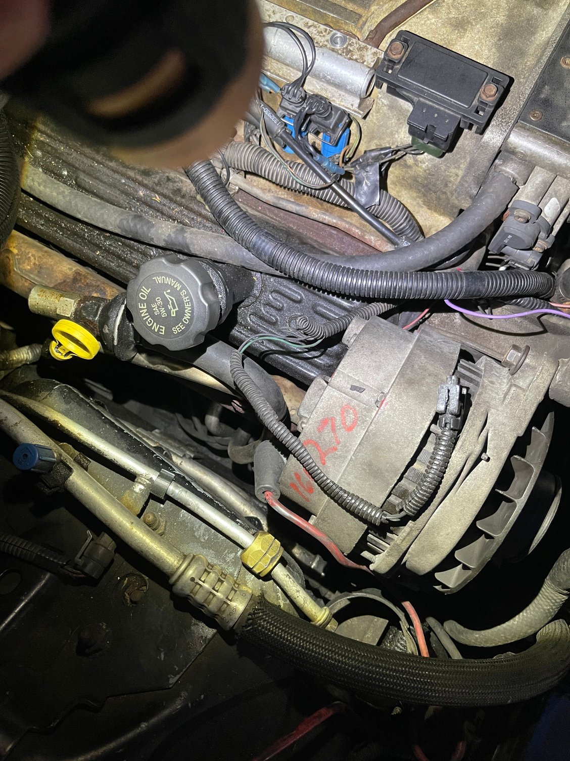

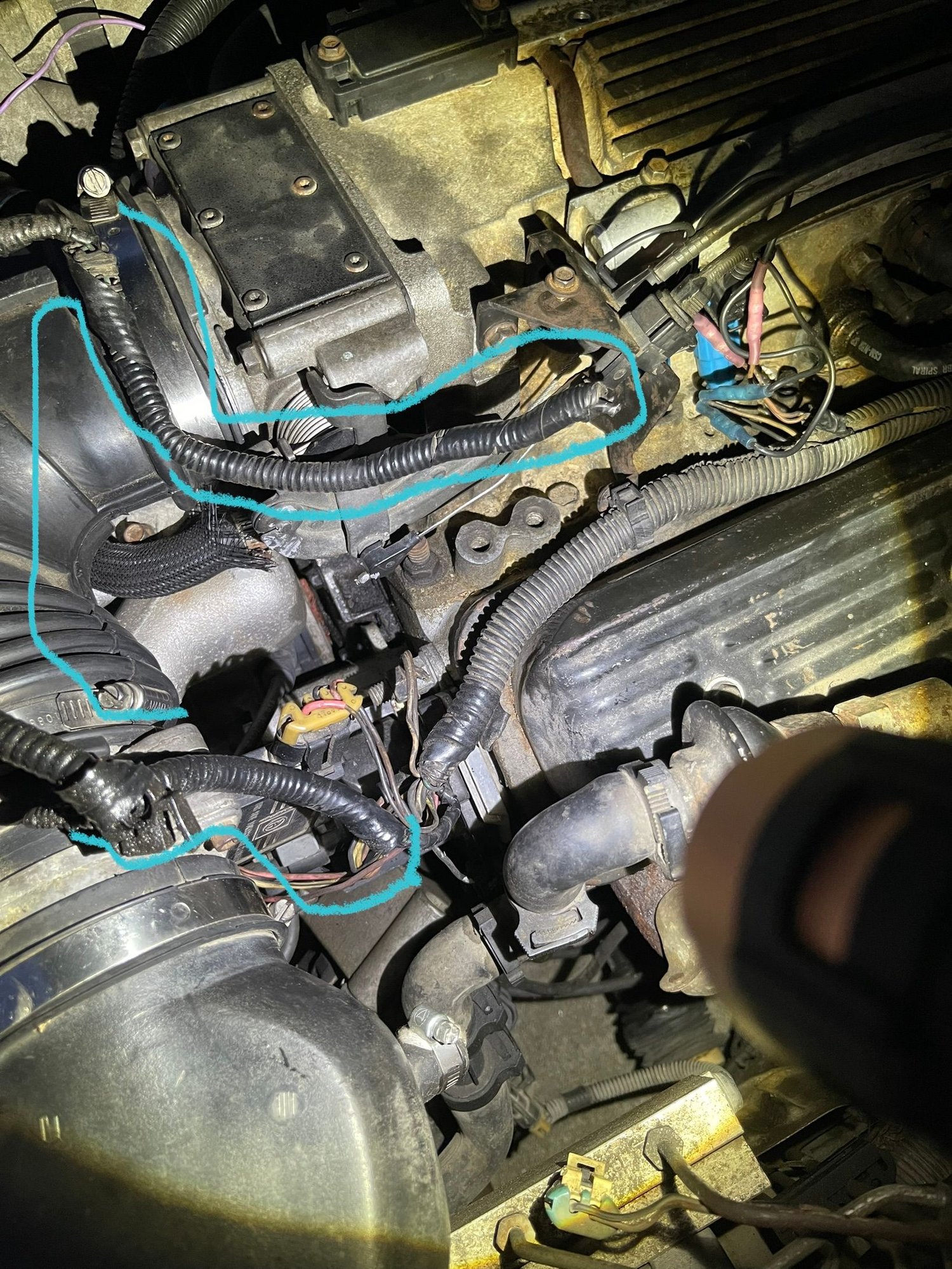

So the first is on the passenger side. Notesaw the accumulator/dryer thing is also missing) maybe it goes to that? Second one was on the driver side. And I’m thinking it might go into the engine? I took another pic of the wire and the location I’m speaking of. Any thoughts or help will be appreciated since I’m new to the lt1. Didn’t know you had to really scour to find things for them. Sheshe haha
This is one on the passenger side next or the accumulator or dryer. Have no clue if it goes into that missing part or something else near there.

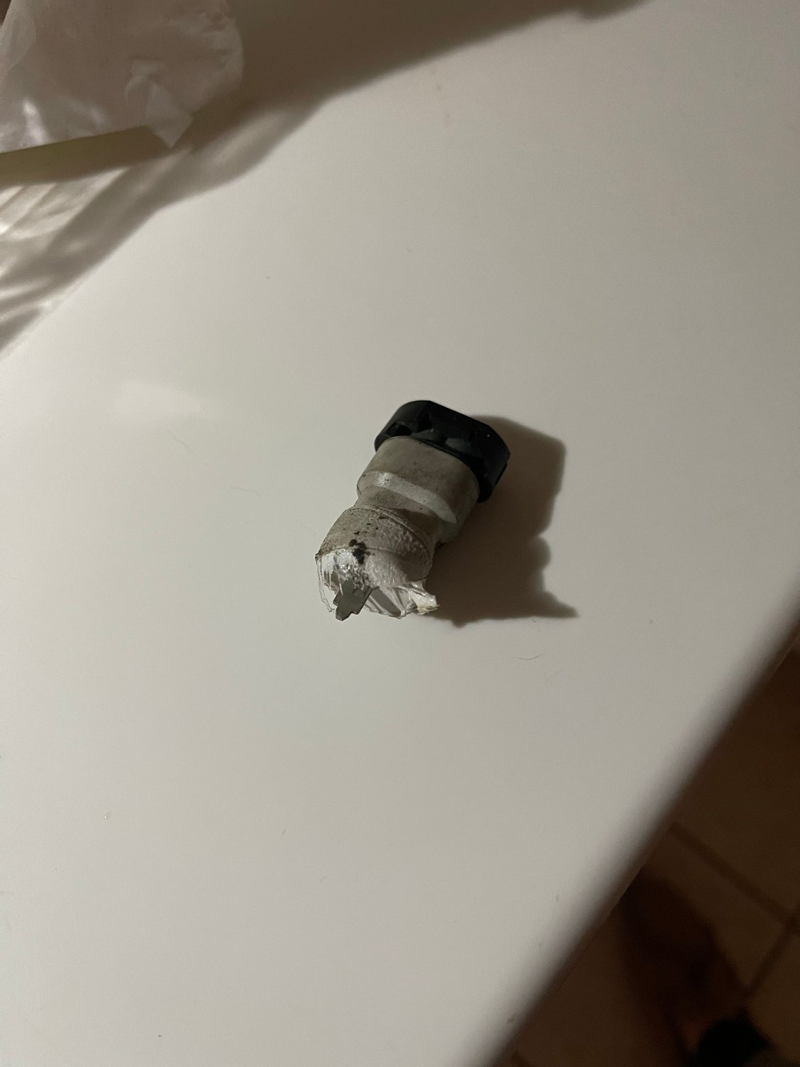

This is the clip that was “attached” to the second wire on the driver side.

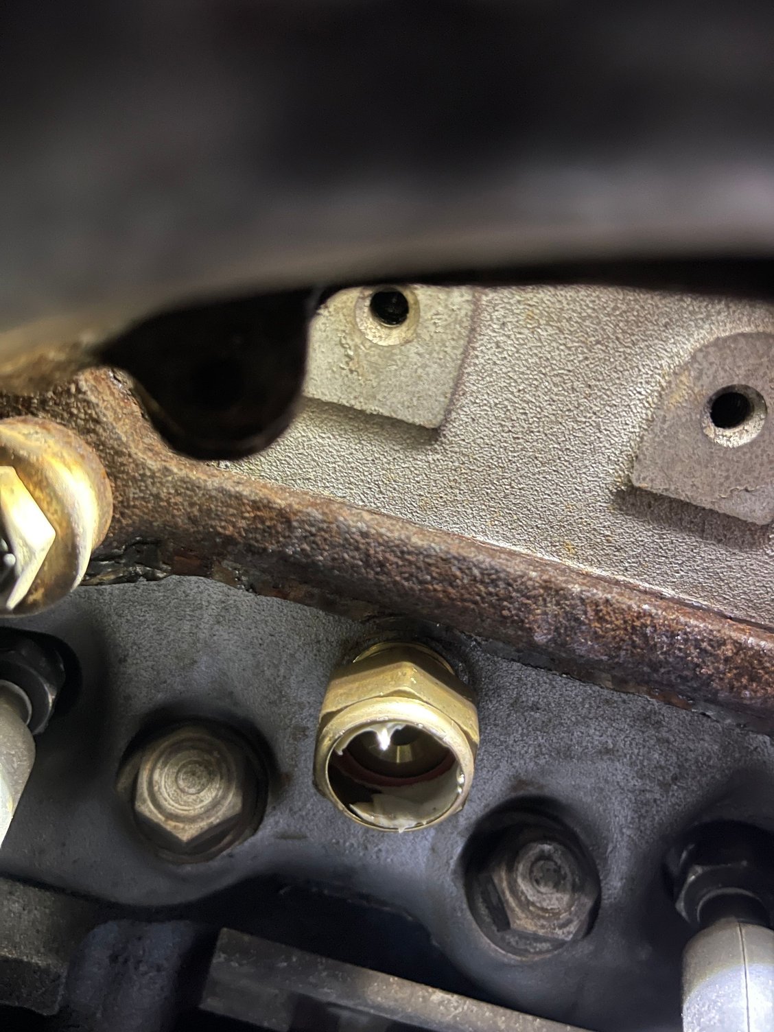

I saw this and thought maybe that’s where the second wire goes? Or an additional thing to fix.. haha 😅😅😂

The first one on the passenger side looks like the A/C compressor clutch connector.
http://shbox.com/1/hvac_compressor_control.jpg
Bottom device looks like the coolant temperature sensor for the dash gauge. There would only be a single wire for it. Look at the harness photo, and the branch that serves the MAF, IAC and coil extends to that temp sensor.

thank you so much. When I find the port should I wait to connect that when I get a a/c dryer because apparently that’s missing too lol
