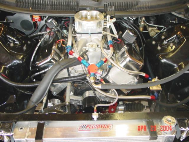

Rich, I'll help where I can, when I can.
the radiator was picked up on ebay for nothing, it's a Nascar Fluidyne radiator.. You can kind of see it here..
http://teamprickracing.com/95z/xxx540/Dsc00894.jpg
We had to run the car for 10 minutes to get it warm enough to make a pass..
(1- 12" electric fan)

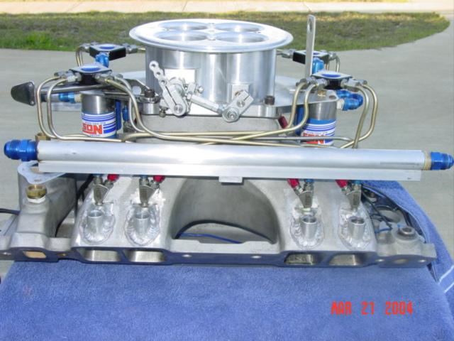

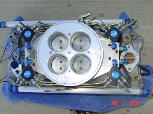

Lonnie, the 572 is a nitrous motor...... May have to spray a 100 shot to get it started.. LOL.. It'll make on the long side of 1k HP on motor, and the dual stage dry fogger will make it completely unmanageable..
http://teamprickracing.com/95z/day5/DSC00876.JPG
http://teamprickracing.com/95z/day5/DSC00878.JPG
The intake will spray 1200.. (not realistic, obviously)
The guy who built the intake went 8.0 @ 3200# on one stage with a 509 BBC, so we're optimistic..
