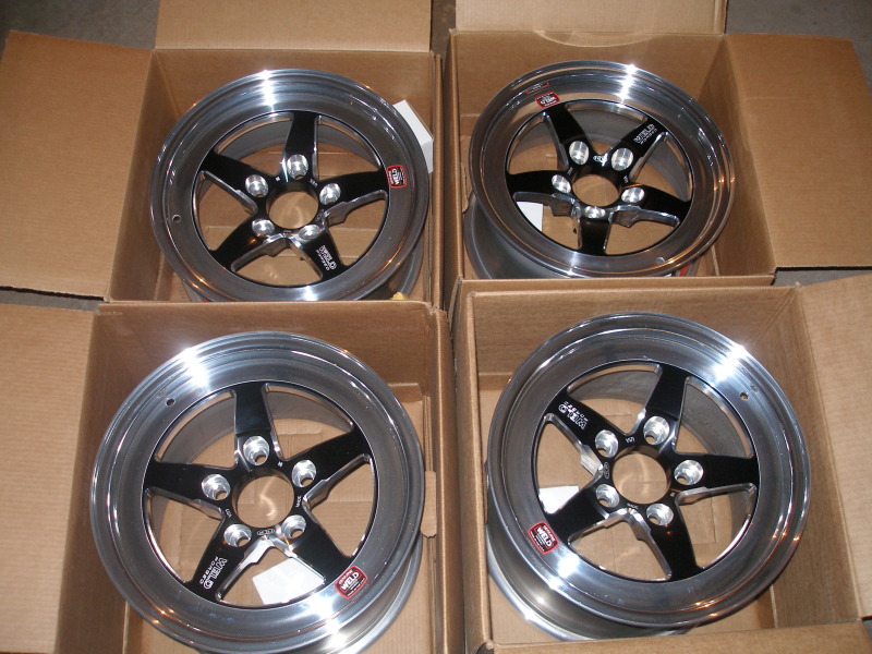

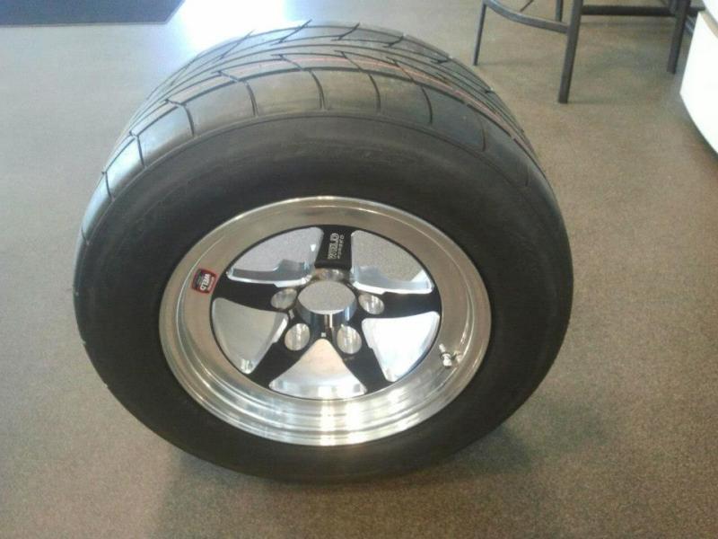

Got my RT-S wheels put on! Ran over to the old closed down BP and took a couple pics.

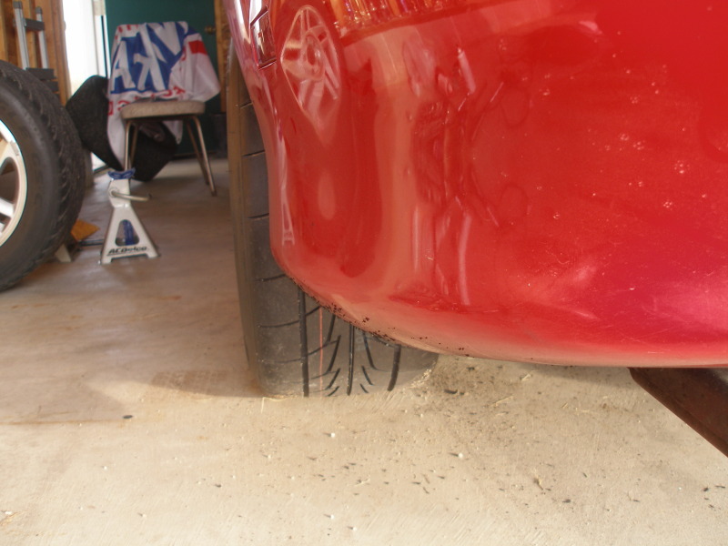

Could you post the info on wheel diameter, width and offset? That helps others know what will fit. Also info on tire sizes.
A shot from directly behind the edge of the rear fender will show how "tucked in" the tire is.

Rear 15x10 7.5 BS med pad
FT 15x7 4.5 BS med pad
Fronts stick out a tiny bit more then I would like, but that was the most BS for 7" wide wheel.
FTS- 225/65/15 Goodyear Eagle
Rear- Nitto 555R 275/50/15
No caliper issues what so ever, not even close.
The rear wheels tuck in great.
