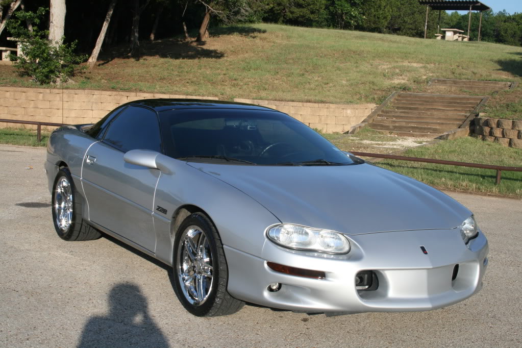

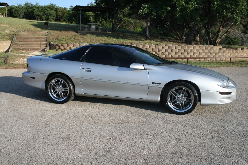

My 18" C6 ZO6's are on!
F 18x8.5 C6 Z06 275/35's
R 18x10.5 C6 Z06 335/30's

Let me know what you think!

They look great with that color car.

I really like it! Nice stance.

Looks good. Surprised those 335's fit in the back.
Could you add info regarding the offset of the wheels. A lot of people want to see how various width/offset combos fit in the wheel wells.

Sure no problem:
F 18x8.5 C6 Z06 46mm w/ 275/35's
R 18x10.5 C6 Z06 56mm w/ 335/30's
F Nitto NT555R
R Nitto NT 555R Drag Radial
All I did was beat the inner finder-well in ALOT and that was it. No spacer's and no rolling of the finders. I do have the new adj. roto joint UMI suspension pieces for the PHB and tubular LCA's. That's all I can think of that might have also made my setup a little easier. Drives great and dead hooks now!
Anything else just ask!

Nitto recommends at least an 11.5" wide wheel for that drag radial, but it appears that the 335/30-18 is narrower than rated size, just like the 315/35-17 is so small it fits on a 9.5" wide wheel, even though Nitto recommends a 10.5" wide wheel.

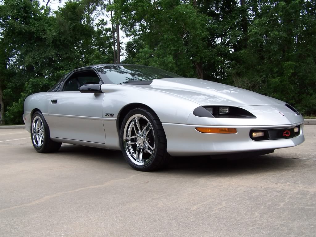

Wow, looks alot like mine.

Mine have 305 Mick's.

DAMN your car looks sweet man!
