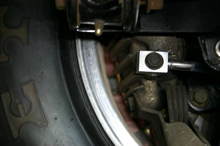

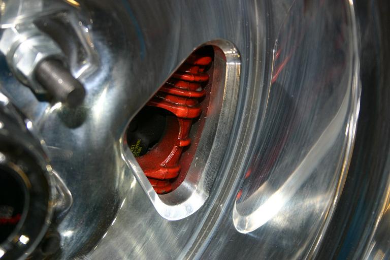

did you have to grind your calipers? cus i have an ls1 and i might get some telstars, but, i dont want to grind, i heard you have to grind MORE than you do if you put prostars. i was thikning i might downgrade to lt1 rear calipers and rotors if i dont have to grind, or grind alot if i do that with the telstars? any help is appreciated! pics is much appreicated!

According to the articles in GMHP magazine regarding the '94 Grapes of Wrath Project car, the Telstars were a bolt-on w/o caliper grinding, front or rear. I purchased the exact set up for my '94 w/ oem calipers and have to use a spacer to prevent grinding the calipers on the front, backs fit fine! So, it must just depend on the car. I am disappointed that I have to use a front spacer because now I have to change wheel studs to meet NHRA/IHRA safety specs. My car is lowered via Eibach springs, but there is no fender rub in the back and I am running the same size wheel as you described. hope this helps!

No grinding at all with LT1 brakes.

they fit on my LT1 but there really close only about a 1/2 inche between the wheel and caliper. on the LS1 brakes I dont think thell fit with out grinding

I didn't have to do any grinding when I put Telstars on my 94.....until I put new pads/rotors on the front. I'm guessing that most who haven't had to grind might run into this problem later on.
Pics are in the sig
