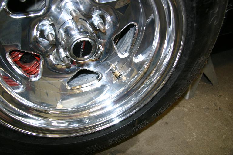

I have the M/T tubes for on mine, I ended up drilling a new hole dead center on my wheel for the tube, I didnt like the fact that if I would have used the factory hole it would have been pulling hard on the stem since the stem is centered on the tube.I left a valve stem in the factory hole with out the core in there so when I fill the tube that all the air in there can be left out of there. mine would only keep air for about 3-4 days with out tubes, now i dont have to touch them.
